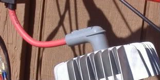

My wire was glued also it broke off inside the cdi box when I went to unscrew it. I just used a pick and scraped it out and screwed in my new wire 500 miles later still works good .

I had leftover wire from my race car. I use Mallory Sprint copper core wire. it's 8mm so I had to shave it a bit, too. I have a Honda replacement coil and it came with a Vinyl boot that stretched over the wire. I also squirted a little silicone into the hole to waterproof.
