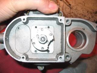

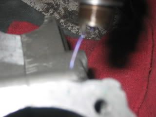

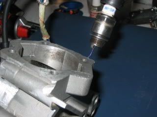

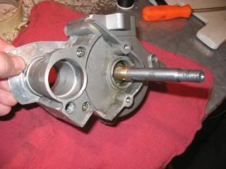

Here is the test rig for testing the magneto coil on the bench. Crude red neck
engineering again. Gutted engine case no crank shaft just a straight through shaft to spin
the rotor. Right now I'm using an electric drill to spin the shaft 2500 rpm max.

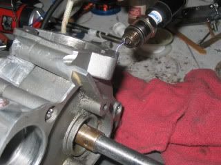

left the shaft long for now this is the back side view

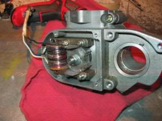

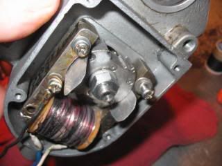

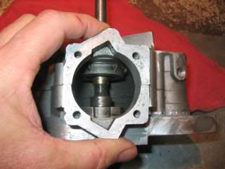

looking down inside no flywheels or crank. cobbled together but it works

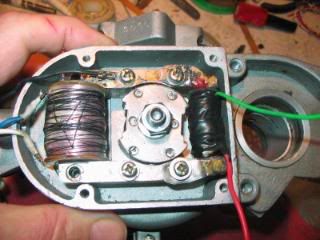

shot with a coil on it for testing
