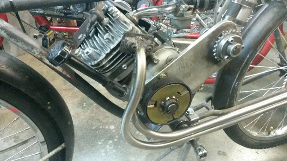

Motors... Yikes! We have in the shop two new in the box 99cc predators and one out the box and used. Then there is a 4hp flat top Briggs and a few others I care not to mention because they are not up for consideration on this build.
It will be the Predator or the Briggs. I really liked the way the flat top looks on a Rat named Ward. I am leaning toward that 4hp Briggs but will remain un decided until mock up. Until then I have a wheel to lace and some metal to love on some more.

We have an EZM on the shelf and also the ability to custom fabricate anything we want.
Then there is the wild card idea. Something I have never used but always intended on and that's the Sportsman Flyer BTR crank set.
Be it a bit pricy when built with the suggested bully clutch. $250 plus $250. Regardless of the cost I earned it, all of it, it is mine to spend and Pat's parts are top shelf.
Full belt drive is something I have not attempted and at this point remain only somewhat interested. I am aware that it will be done at some point. If only because we can and have not.

That bike really has nice lines & proportion! Classic Americana.
I don’t normally spout unsolicited opinions, but I think the Briggs would suit it better...
