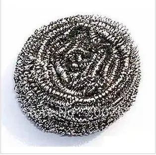

I stuffed half a brollo pad into my exhaust to try and quiet my bike somewhat, think I over did it, lost about half my power.

Brillo pad is full of soap use steel whole,prolly half as much LOL..actually stainless scrubber from dollar store is more coarse .........Curt
Yep back pressure like that will wipe out the power of these little engines, like curtisfox said a stainless steel or ever pure copper scrubbing pad like can be found at dollar stores and such is your best better as baffle material to quiet i5 down some, but just be aware that even a small amount of it in the pipe will cause you to loose some power since it restricts flow.

that's what I used, probably shouldn't have called it a brillo-pad, but you know it's like kleenex. I ened up stabbing it wil some wire untill it loosened up, seems to have helped greatly!
