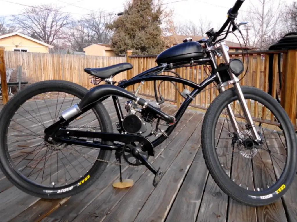

    In my opinion get a grubee with the standard NT carb. However,
    Instead of doing this, here is a second option. Measure your mount holes center to center, should either be 1.6in or 1.9in. Then, check out sickbikeparts.com off the homepage, find the large front engine mount and select the 1 5/8 - 1 3/4 mount. Buy it and believe me it worth the 3 day wait. Install it and there is no need for any jb weld or quick steel caca. With their mount it's a perfect fit and the rear mount just needs to be ground 1/16 on each side. I recommend their engine hardware kit as well. Do it once, do it right. Check mine out, same bike with recommended mount. Let me know if you have any questions?

  8. Ursus
    Ursus New Member
    Joined:
    Aug 12, 2010
    Messages:
    45
    Likes Received:
    Unfortunately i didn't have a file or a grinder. Quiksteel cost me 3 bucks and the u bolt cost me 1.25 I got them both at home depot. I had a square piece of steel lying around. No shipping no waiting. Except the 15 minutes it took for the epoxy to set. Epoxies today are not the same as they were a few years ago.
