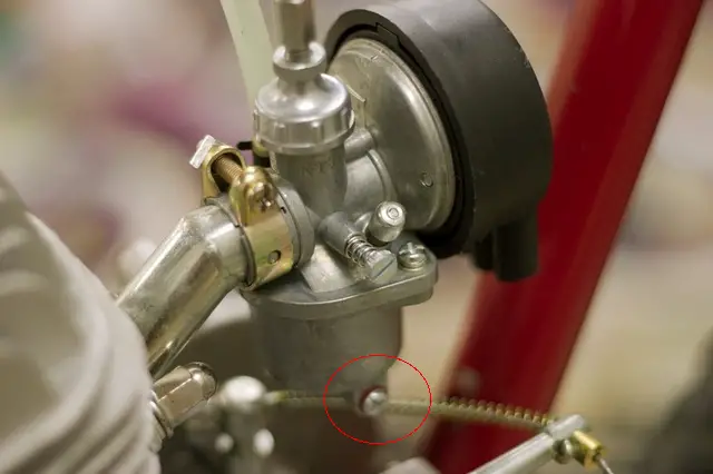

    i went and got a tarp to keep it covered when i am not riding it, as soon as i find a solution to the gas leak i will keep it inside, the leak is this screw located in the picture
    [​IMG]
    i have tried everything from teflon tape, washer, everything..im about to just go get lock tight and seal it down.. any suggestions?

    SealAll. It is a product sold at most auto parts stores made to seal gasoline leaks. That drain screw is not necessary. many NT style carburetors don't even have one. If you need to clean the bowl, completely remove it. The drain is not needed, seal it with the product recommended.

    Hmmm, wonder if there might be a hairline crack somewhere in the housing around the screw? Shouldn't be still leaking from all you have already done!

    not no crack its the screw itself, it wont tighten down all the way, the threads on the inside of it are messed up so it wont properly tighten...i mean its tight but still has play if u mess with it and a screw driver.. i will look into the seal all and just seal it up, i mean this thing gets pretty good mpg but still its wasting gas, debating on just taking a soldering gun and sealing it up with some solder,

    If the threads at the end of the screw next to the head are bad, but the rest of the threading is good, you could cut out some additional washers from some gasket material for the screw, to elevate the head away from the bowl to the point where good threads are engaging and sealing the threaded hole.

    Yea my drain screw also has gas around it, I can always tell that the red washer thing is soaked. Oh yea mine is also wrapped in teflon tape as is all 3 screws holding the bowl on.

    well that screws the only one giving me problems, and its a pretty bad leak, within an 8 hour shift at work all the fuel in my line is gone, if i was too accidentally forget to turn the fuel valve off i would prolly be out of gas.. but i got a plan, tomorrow i am gonna take the screw out, drain all the gas in the line, then cover the screw in a silicon sealant, put it back and then more sealant around the screw and washer, let it dry all day while i am at work and see how it holds..im pretty confident that it will take care of the problem lol
