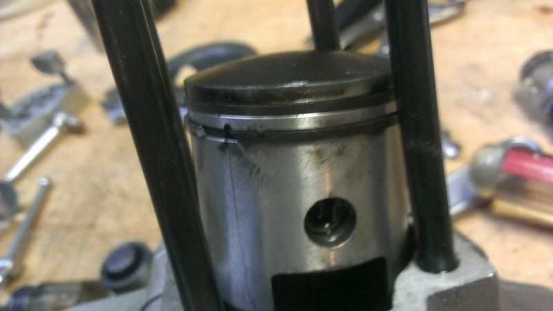

    Cracked rings from the factory

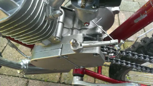

    Snapped ear from poor casting techniques

    I have built several dozen of the ebay chinagirl kits so I have some experience with them.
    I'm not going to argue quality with you on china girl motors as my opinions are well documented elsewhere in my reviews and comments.
    I feel obligated to point out the broken case looks like a classic example of a too-loose chain catching on the case upon starting, so it is possible this particular problem was your fault rather than the manufacturer or materials.
    Not throwing rocks, just pointing out the obvious. There is no doubt you got a bad motor from the pics of the top end. No new engine should look like that inside before it ever starts. Yours looks like someone blew it up and returned it and the vendor sold it to you again afterwards.
    Looks like you got a bad vendor and that sucks. Not all vendors are bad. Don't condemn the entire industry on one bad purchase.
