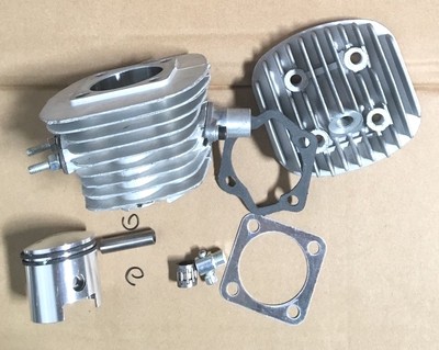

Duane from Thatsdax got out of the business. However, most of his china girl engines were PK80's with the short connecting rods, they require the 47mm piston with the low wrist pin. The rest of the top end is stock using 8mm head studs. This one
