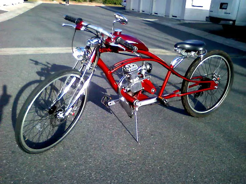

    So I'm working all the bugs out and it seems I am running good. Until I hit 20-22 mph, then the engines sounds different and pulls like crap. Noise changes from a whahhhhhhh to a Brrrrrrrrrrrr. Then I can feel the motor pull, let go, pull, then let go. I probably have around 50-60 miles on it. i would know exactly but my digital bike speedo keeps resetting itself, grrrrrrrrr.lol. usflg

    I'm taking a guess here, your runnin a 2 stroke. Sounds like the old "too big of a jet syndrome". Something to try(once), get on a long stretch of flat road, wind it up until it "4 strokes" Brrrrrrrr as you put it, basically falling off on power/bogging etc.. ANYWAY, when it's doing the bog, shut the gas petcock OFF, keep the throttle on, If in about 10 seconds, it starts to pull again for a consistent time(a few seconds), the Jet is too big. there is a procedure to make the jet the right size, Norm helped me with this, I believe the thread is in "Norms 2 stroke repair center" 4 stroking at WOT

    If it is a Chinese in frame 2-stroke, the engine will not run perfectly until after the break in period. That takes about 2 to 3 gallons of fuel and 500 to 700 miles.
    What oil ratio are you mixing your fuel at? 16:1 to 20:1 is the general accepted ratio for break in. I prefer 25:1 myself.
    What color is the spark plug at the electrodes, the part inside the engine?
    It should be a flaky looking brown to black, but not wet looking, when a heavy break in fuel to oil ratio is used and you have a good air to fuel ratio. If it is black and wet looking then you are running a bit rich on the air to fuel ratio, which I suspect you are. Check it and get back with us. Armed with more info we can help you out better.

    If your spark plug is a milky brown then you are good to go for an engine that is broken in.
    Since yours is still in the break in mileage, I would like to see it more like a dark chocolate brown. This slightly rich fuel/ air ratio insures that there is a little bit extra oil getting to the engine's internals and it burns a bit cooler than a leaner ratio.
    The too big of a jet syndrome leans towards a very rich fuel/ air ratio, which would make the spark plug black in color. This also causes "4 stroking". This may still be possible in your case and will only show up during 3/4 to full throttle operation.
    I now suspect that you may have a bad spark plug or spark plug wire. Either of these problems will cause poor operation at higher engine speeds. With all the previous questions and checks, we have pretty much ruled out carburetor jetting and oil ratio problems.
    Oh yeah I almost forgot, are you using the stock plug in wire connectors between the engine wires and CDI wires? Those are notorious for being a problem. If so, suspect them before a bad plug or plug wire. Solder them and use electrical tape, or for the best job use heat shrink tubing, to seal and insulate them.
