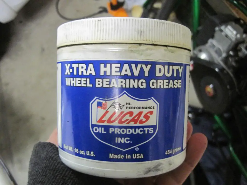

    I have been using a Lucas brand high performance grease on all of my parts. I buy it at home depot near the WD-40 if it helps any :) I recommend this grease to all of my "grease-monkey" friends.
    [​IMG]
