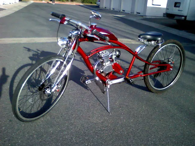

    "Maintaining" speed depends on whether you ride in a flat or hilly area. If you ride in a flat area, depending on the gear ratio of your rear hub, you can maintain an EASY 40mph. Good wind behind you 50mph is possible. Helmet and disc brakes recommended at those speeds... Just upgraded to disc brakes on mine. Took me 1/2 block to stop from full speed before I did.
    #17 Maxvision, Mar 26, 2010

  20. macattie88
    macattie88 New Member
    Joined:
    Dec 2, 2009
    Messages:
    102
    Likes Received:
    max...im not into stretch bikes but yours looks awesome...good work.
