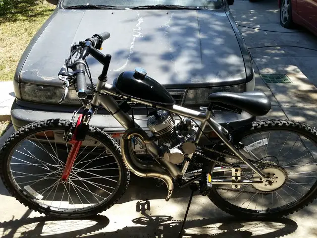

    I have bought my plugs at my local motorcycle shop and I have ordered the same plugs from SBP ( sick bike parts ) http://www.sickbikeparts.com/catalog/product_info.php?cPath=22&products_id=142 I run the B6HS but I think many people use the B7HS in the summer since it is a cooler plug, I run the B6HS year around with no issues myself.
    With the SBP expansion exhaust the sound level is very good and not to loud at all, this pipe actually helps low to mid range power and may add a couple MPH more top speed to you r bike as well, I have this pipe on my older HUffy bike, I didn't use the silicone tubing to join the pieces together as my final set up though, that tubing will burn out in time so I used simple copper tubing fittings instead and it has been running great for a little over 1,300 miles now, the pic I included here shows how I mounted the pipe on the Huffy bike, the engine on this bike has serious vibes above 34 MPH but this pipe helps it pull really good from about 10mph all the way up to 32-34MPH.
    This pipe can be mounted so that it is low down also, this is just the first way I did mine and I liked how it turned out so I have left it this way.

    That pipe does look good mounted high... I need a seat like you got too...
    About the spark plugs, the NGK numbers Map mentioned are what I run, but when I need cheap plugs for tuning purposes, the Autolite # 275 plugs also fit perfectly and you can buy a pack of 4 for about $8 or so, they're cheap but also better than the stock plugs which makes them great for tuning and doing plug chops with.
    i'm running a modified KTM 50 dirtbike pipe on mine and the performance gain is night and day compared to stock, I noticed it pulled a Lot harder the first time I cracked the throttle and the top speed went up pretty good too, even with a 44 tooth rear sprocket I gained about 2mph. My first pipe was one I made out of an old pocketbike pipe, it worked great on the low end but the muffler was too small and top end was about the same as stock, the difference in acceleration was definitely worth the effort tho.
    Here's mine with the modified pocketbike pipe installed...
    [​IMG]
    And this is how it looks now with the modified KTM pipe.. I liked the first pipe I made up for it but it lacked top speed and burned my leg once before so I made this one more forward and out of teh way... this pipe accelerates the bike really nice too, but it gives me the better top speed that the other one couldn't do since it has a bigger stinger diameter... even with no muffler it's not any louder than the pocketbike pipe since it exits down and close to the road.
    [​IMG]
    [​IMG]
