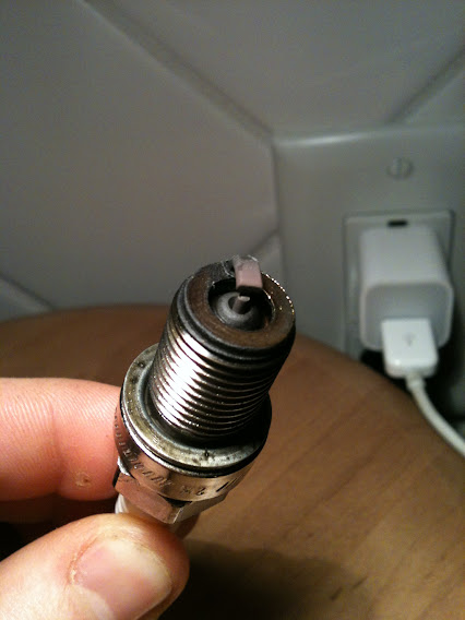

    Road my boxer around for the first time last night and today. Starting to run really well. Have not dealt with a 2-stroke in awhile so wanted to get some opinion on my plug. Probably 20-30 minutes total runtime and this is what the plug looks like.
    [​IMG]
    [​IMG]
    [​IMG]
    have not really gone past half throttle yet.

    The tan color is right. White is too lean or too hot. Black is too rich or too cold of a plug range. It looks like your right on the money :)

    That Gray Color is not good. You are way too lean. Gray means you are cooking aluminum and it is becoming deposited on the tip of your plug. You are way hot !! You need to start out safe. That means.. Rich !! And then work your way towards the toasty brown color. Mix 25:1, put in the next fatten up your jetting until you get some 4 stroking.. Once you find this point, then put in the previous jet that had minimal 4 stroking mis firing which ever you want to call the misses. My factory Race Kawasaki recommends never leaner than 32:1. So.. To be safe, work towards this goal of 32:1 if you like. Bottom line here is to be safe and not damage engine. Running too rich you can fix more easily than a hole in the piston. A gray plug is telling you that you are headed towards a hole in the piston !! Fatten up now !! And then work your way towards a cleaner more powerful burn rate.. Enjoy the ride.

    ok took a new pic just a bit ago. Didn't run it or anything. This is grey? I feel so worthless .kick2
    [​IMG]
    also the jet in it is a 94. what size jets should I order? was thinking I would order three or four. Probably 96,97,98 unless someone more knowledgeable wouldn't recommend a bigger jump

    Yes.. Order those jets,, Start out with the largest one and work your way back. Grey color is not good. Toasty Brown is good and what you want. Also.. You can get an infra red Thermometer as checking running temps can also help. Cylinder head temp Ideal should be 375-385 degrees. 410 degrees or higher will burn your engine up. Measure Exhaust temp approximately 3 inches from Ring 1175-1185 is perfect. Enjoy the ride.

    I don't see any grey to that plug. It looks just fine to me.

    That plug looks on the rich side to me, however since you mentionned power cutouts, the air/fuel mixture might be varying with time which would make it impossible to know if everything is right by checking the plug. If your fuel tank did not vent properly, it is possible that your air/fuel mixtures goes from rich (when the carburetor floatbowl is full) to lean (when the floatbowl empties itself with time as a vacuum creates itself in the tank). That would both cause a rich AND a lean mixture. In case of doubt, open up the carburetor floatbowl and check for the float/valve proper operation : fuel should fill the floatbowl when the float is held down and should stop filling when it's held up. I would do that for my chinagirl so I strongly suggest you doublecheck that since you have a beautiful italian girl!
