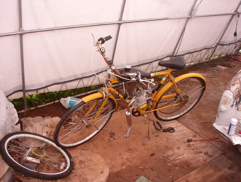

Oh, here is the bike ( no other pics, and I have since completed it.. chain was shortened )..
