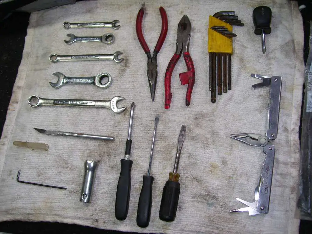

  8. Russ McClay
    Russ McClay New Member
    Joined:
    Jan 21, 2013
    Messages:
    85
    Likes Received:
  9. Toothy
    Toothy New Member
    Joined:
    Mar 25, 2014
    Messages:
    181
    Likes Received:
    Wow.....I guess you have to have a tool for any situation on a trip like that. What do you use the rubber mallet for?
  10. Russ McClay
    Joined:
    Jan 21, 2013
    Messages:
    85
    Likes Received:
    The mallet is to adjust the chain tensioner. I cut a small piece of an old handlebar grip and wrapped that around the chainstay over which I clamped the tensioner, the logic being that handlebar grips are notoriously sticky, so that would eliminate the tensioner moving left or right. When I adjust the tensioner I just loosen the bolts enough so that a little whack with the mallet can move it with microadjustment.
    Anyhow...I hardly ever adjust the chain anymore...but keep the mallet just in case.
