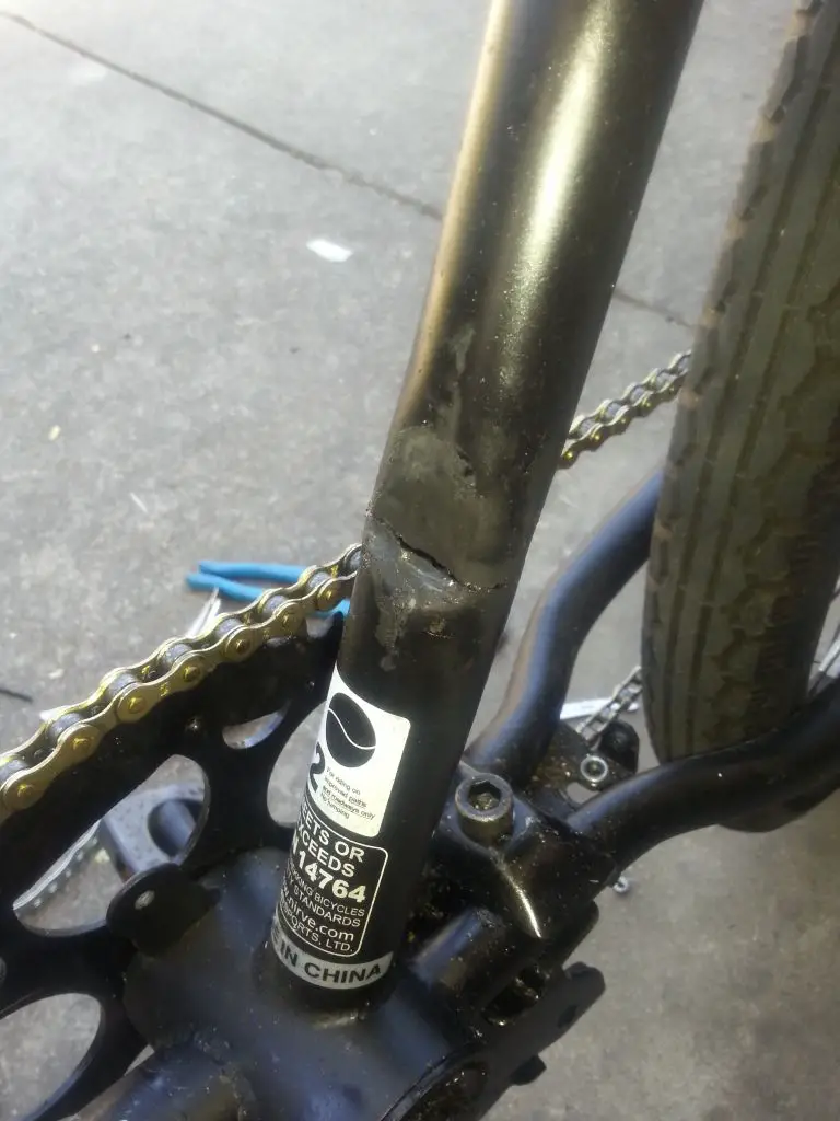

    So I've been working on this thing since last summer, pouring around $800 into this thing, being a highschooler... that's a lot.
    I've always had problems with this thing, having to replace part after part, and never had it working for more than a 2 weeks, something eventually goes wrong. I admit most of those things are my fault, but it's really frustrating to have to push this heavy bike a couple miles up hill whenever it breaks down.
    This weekend I saw one of my front mount studs broken off, I can't easy-out the thing, it won't work. Then I saw my down tube has a big crack.
    I think I'm done -- how much should I be able to sell this on craigslist? This really greasy engine, and cracked Nirve B1? I guess this is more of a rant... hope all goes well for everybody else.

    The Nirve B-1 is a steel framed bike. I'm very surprised the frame cracked.
    Would it be possible for you to post some closeup photos of your engine mounts, both front and rear? That would help us diagnose what might have caused the failures.
    As for other problems you've had, what were they and what did you do to fix them?
    We'd hate to see you give up even though I can understand your frustrations. Stick with it just a while and let's see if we can't talk you through some of the issues and get you back on the road with a little more reliability that you've had so far.

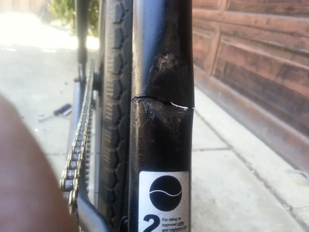

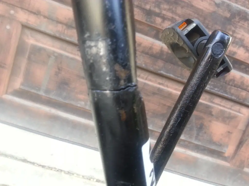

  6. MysterySandwich
    MysterySandwich New Member
    Joined:
    Jun 30, 2012
    Messages:
    196
    Likes Received:
    Yeah, plenty of things I learned also, I thought I was going to stick it out, but this cracked frame... I might push through though, maybe..
    I did a ton of research before I started, I spent the extra $100 to buy the better engine kit from VMB, found a good base bike, and did all those things like cleaning out the gas tank, loctite... I watched a ton of tutorials on how to build them so I could see if I could do it or not
    Uhmm I don't know where to start, one of my first problems before I even mounted the engine was that the sprocket cover screws were stuck and the heads were messed up from me trying to get em out. (Easy out didn't work, I tried JB weld'ing a bolt to it, eventually I just took a big drill head and completely removed the screw heads)
    Let's see... my first base bike turned out to have a faulty rear wheel (I thought I got a bargain on CL, that's when I went big and bought the Nirve B1)
    Had a fuel leak problem once (one of those things that were my fault... I just ended up buying thinner fuel line), one time I was riding back from school when something happened to my spark plug/wire (had to order new ones off SBP), multiple spark plugs fouling even though I was following rules on oil/gas ratio and setting my carb right. And some other less-headachy ones.
    Here are some pics
    I'm pretty sure I tightened the rear mount quickly, I should've bought that torque wrench...:

    I'd really like to see how the front of the engine was mounted. You weren't using rubber in the mounts, were you?. That frame failure would be consistant with the front mount not being solid enough to keep the engine from vibrating. That is a stress failure caused by something being much too loose and allowed to vibrate against the frame.
    My guess would be that the front mount fastener failure contributed to the damage I see to the seat tube. How long did you ride the bike with the broken mount?
    Failure of the kit supplied spark plug boot is very common. It should be replaced with an automotive quality part during the initial installation of the engine.
    Fuel leaks are easy to diagnose and repair. Really not a big issue but they can be aggravating, no doubt. Sounds like you took care of that.
    Your frame could be repaired. It will take a welder with experience in welding thin material. I'd suggest cutting the tube and doubling it with a stub on the inside to add strength. Easier said than done however. A doubler welded to the outside of the tube would work but that will increase the size requiring some modification to the engine case/mount. Too bad you can't hook up with Ocho Ninja. He'd be able to help, I'm sure.

    Nope no rubber mounts (I remember seeing you post about those saying we should just deal with vibrations) I was using a U bolt and this metal rectangle with holes for the mount studs/U-bolt. I rode it for only a day without the front mount... I guess before it was broken it wasn't as secure as it should've been?
    Unfortunately, there aren't any weld shops around me (there WAS a machine shop, but they closed down a couple years ago). I'd have to travel with a car somewhere far... the 'rents would not be willing to do that. Of course money is another issue to pay the welder anyway

    Was your rear mount flat against the seat tube?
    It looks like the sharp edge of the mount block was digging into
    the tube and the tube got crushed.
    Also the paint is rubbed off so was it loose and sawing on the tube?
    Maybe save the frame by putting a tight fitting piece of pipe/ tubing
    down the seat post.
    An extra seat post all the way down to the bottom bracket might have
    saved your frame?
