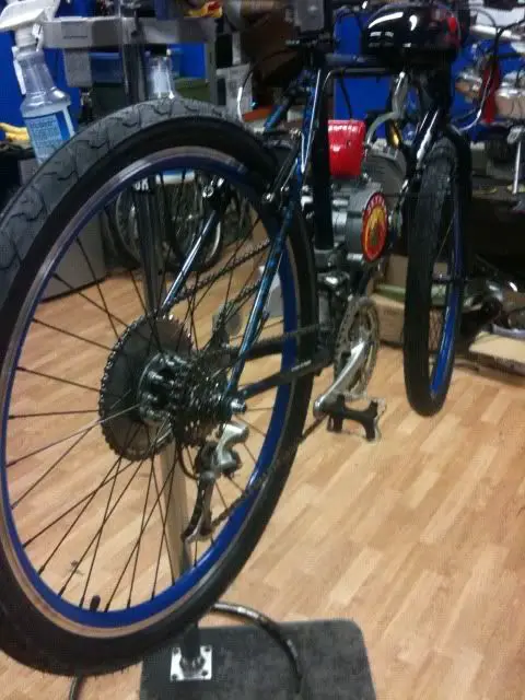

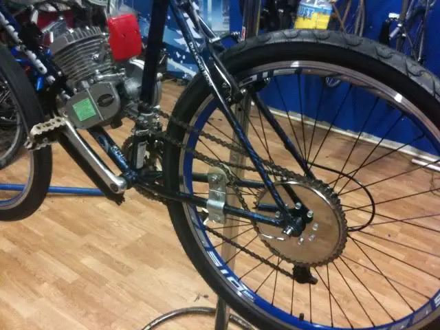

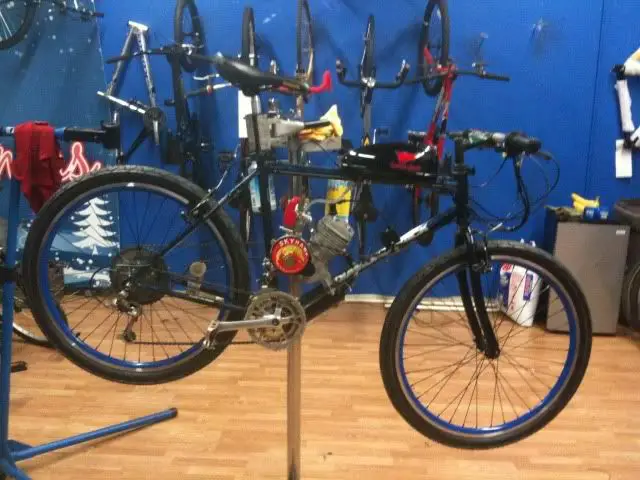

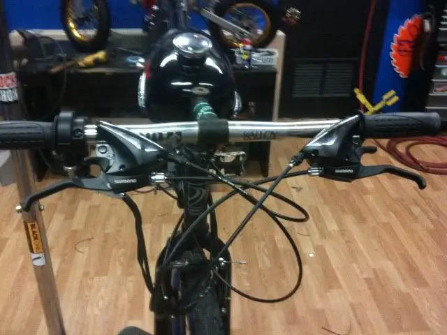

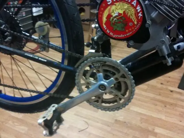

    so I got it done.
    It's a cromo diamondback. The kit is a Grubee 80cc slanthead. I put new brakes shifters wheels and seat on it with the kit. I fixed the front derailleur and ran the clutch pull into the leftside shifter, really the action isn't any harder than moving the old derailleur. Got it all buttoned up night before last and shoved out into the darkness and nothing. I've got spark fuel(wet plug) and compression, wtf. My mix is 50:1, I plan to drain the fuel and remix(wicka wicka) to a 24:1. Wish me luck.
