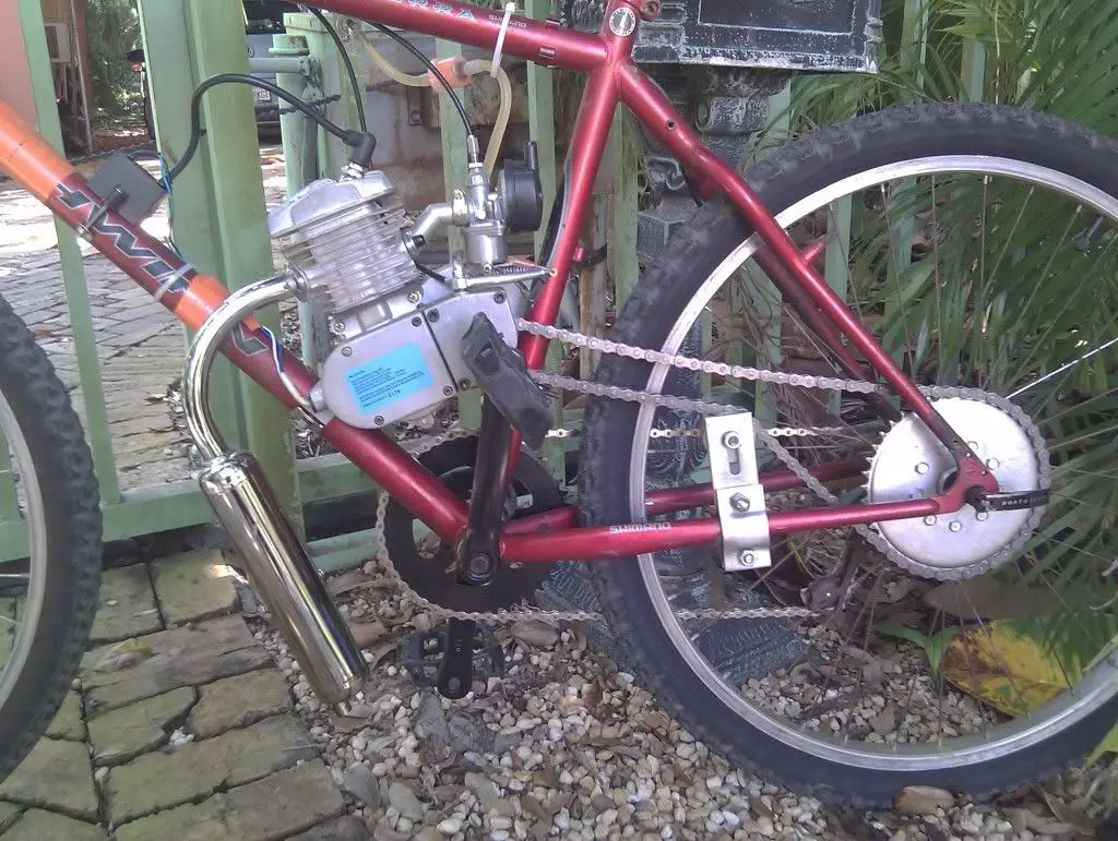

  15. Basement Cat
    Basement Cat New Member
    Joined:
    Mar 14, 2011
    Messages:
    26
    Likes Received:
    I didn't realize these engines were built to rev so low. Some of my Go-Ped engines easily rev up to 18k under load and the lowest revving engine I've built went up to 12-12.5k, lol. I suppose I'll just go slower for now :(
  16. Basement Cat
    Joined:
    Mar 14, 2011
    Messages:
    26
    Likes Received:
    I've got a picture of my setup, does it look right?
    [​IMG]
    Also, the crankcase is leaking fuel/oil. Has anyone else had this issue?

  18. PerryP180
    PerryP180 New Member
    Joined:
    Jun 24, 2011
    Messages:
    79
    Likes Received:
    You have the NT carb in the photo. I had what I thought was fuel leaking from the engine. After many hours of searching I found the leak to actually be on the nipple where the fuel line connects to the carb. The nipple is so close to the carb wall that I couldn't get the black fuel lines to seat properly. The walls of the fuel line are too thick. I've gone back to a clear fuel line (has thinner walls), used a small zip tie to clamp it and I've had no problem. I also put the sip ties on all points where the fuel line is over a nipple. (fuel filter and petcock) The clear line works but it does expand in heat and it will get brittle in a few months and need replacing. As for engine vibration, sound like the mounts aren't tight enough. Also remember that the smaller the bike frame the worse the vibration will be. I tried a small framed mountain bike and the vibration was significant. I now use larger frame cruisers and have very little.
