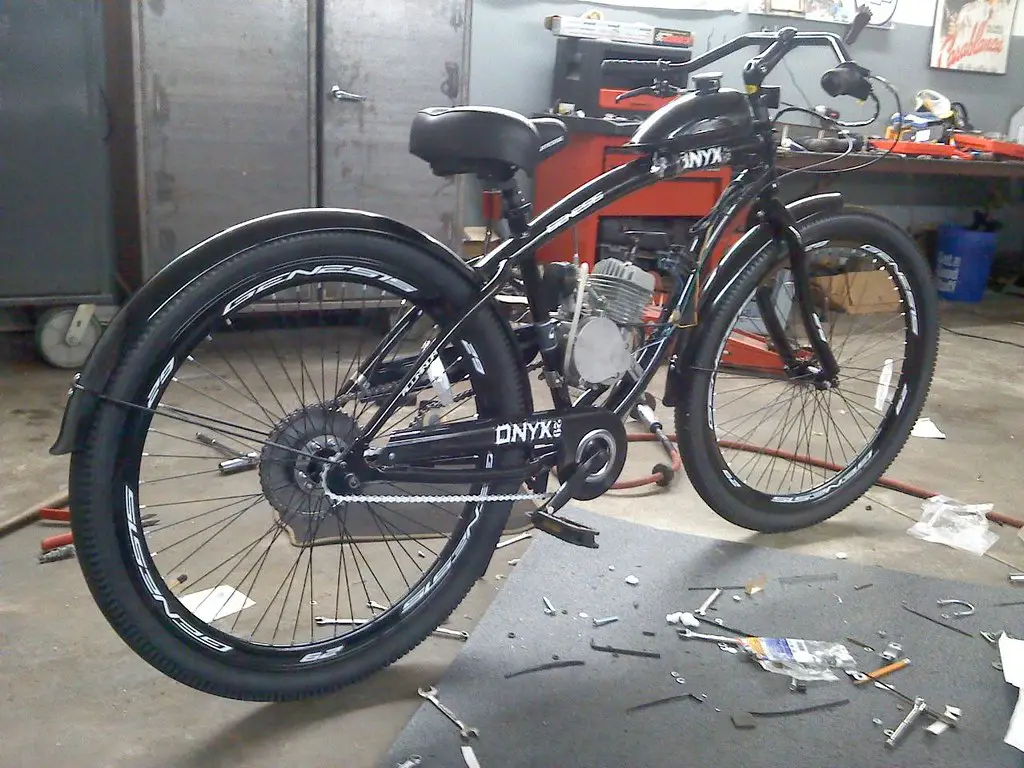

    My 69yr old dad just finished his Onyx build and took 'er out for a spin! Used the Dax kit. He was able to get everything successfully mounted to the big frame with the help of some new brackets and such. He did have to swipe some bars from an old trike we had in our barn. After some paint and trimming, they work great! I think the bike looks pretty good!

    Nice bike. I just did the same bike. Did he notch out the rear fender so the chain has clearance? I need to re-install my rear fender.

    nice build i love the 29ers.....im looking for one in oz but no luck yet.....make sure you loctight that fender or youll be sliding down the road at 35 and thats not fun trust me i know.....i trimmed mine drilled a new hole and fitted hd lock nuts...

    Other then the cool look, are the fenders necessary for it? Would it be less safe without them. And is there anyway to make them stronger and less wobly without having to use a welder? And did the throttle fit on the stock handlbars or did u have to modify them?

    The stock handle bars won't work. Too large in diameter. He used a set from an old trike we had. Fenders aren't necessary. If you do run them, tighten them down and use red loctite.

    A lot of people have had trouble with fender supports breaking from vibration. It's something you want to keep a close eye on because sometimes the fender will wad up and lock the wheel.

    I used the stock bars but cut off the ends and welded on smaller diameter tube so the throttle and clutch lever would work. I really like the fenders. I put thin rubber from a blown bike tube between the supports and used locktite on everything. The fenders really ad to the look I think. They did vibrate like mad though without the rubber. (can you say metal fatigue).
