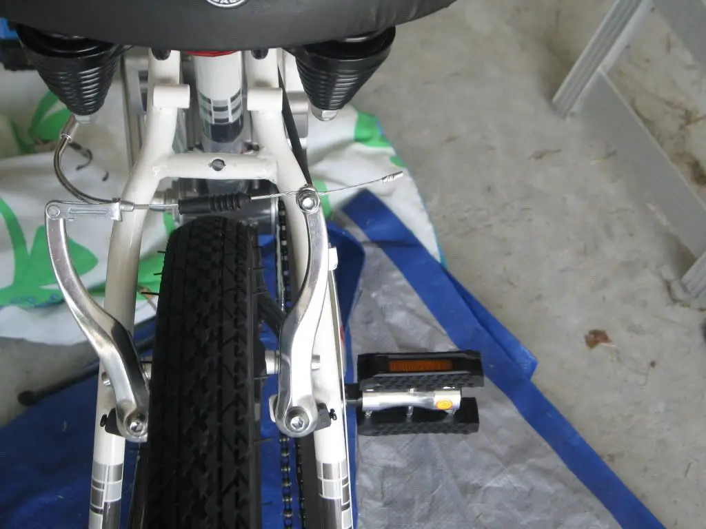

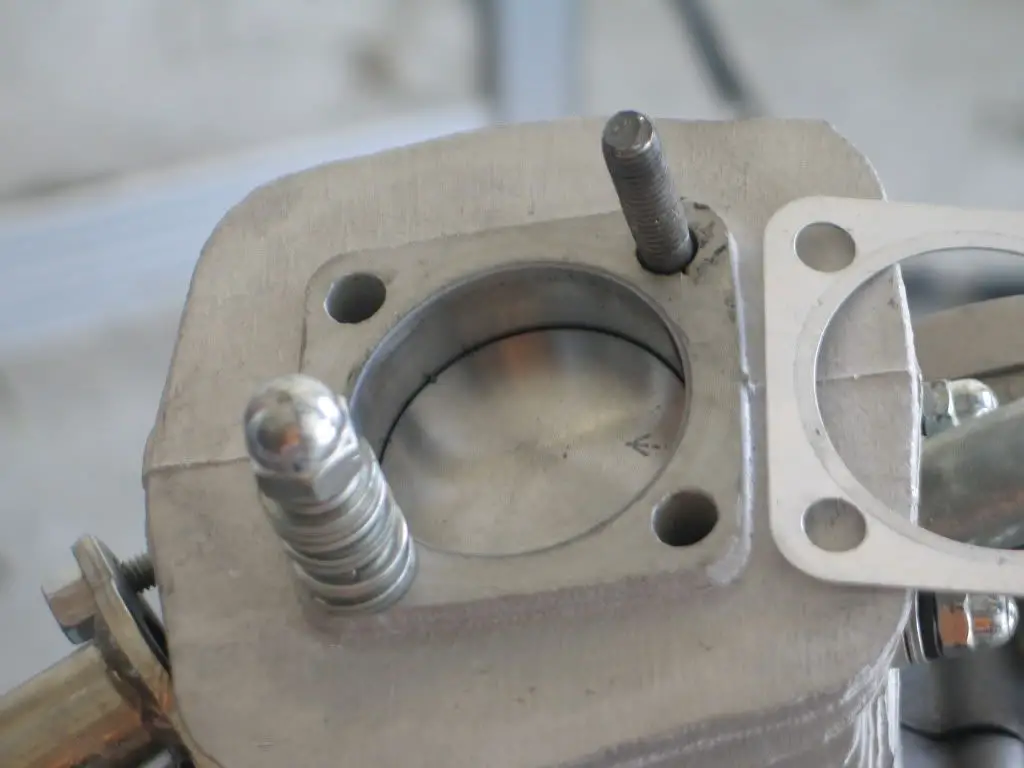

    Thank you Wheelbender6 I have a few questions (1) I am posting a picture of my head and I am thinking it has a jug insert or maybe its just polished although I think I see a small lip (2) I have a rear centerpull that I am picturing where one side is way further out than the other.any help is appreciated ......Thank you

  6. wheelbender6
    wheelbender6 Active Member
    Joined:
    Sep 4, 2008
    Messages:
    3,824
    Likes Received:
    12
    The rear brake has small adjustment screws on both sides to help you keep them centered.
    I'm not very good at engine internals. so I can't help with the first question.

  8. timboellner
    timboellner Member
    Joined:
    Apr 1, 2009
    Messages:
    435
    Likes Received:
    The cylinder bore doesn't have any type of insert.
    It has a cheap chrome coating which is quite hard, but can chip and peel.
    Unfortunately you can't hone or re-bore theses heads, but they are inexpensive to replace if and when the time comes.
    TiM
