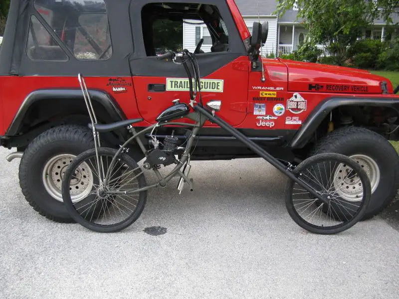

    my front fork is 4' long. i built it as a triple tree out of 1.5" Diameter .120 wall DOM steel roll cage tubing.
    the fork itself weighs about 25 lbs. I have no problem keeping weight on it. BUT, with the SBP jackshaft kit, i have the ability to pull wheelies if i want to.
    here is a pic of when i was almost done building it.
    [​IMG]

    Now that looks like a wild ride!How dous it handle at speed?
  9. DJEEPER
    DJEEPER New Member
    Joined:
    Nov 9, 2009
    Messages:
    52
    Likes Received:
    she handles GREAT.
    only time when it is squirrely is at low speeds ~2mph. even then, its very controllable. you just have to compensate for the extra weight of the steering
