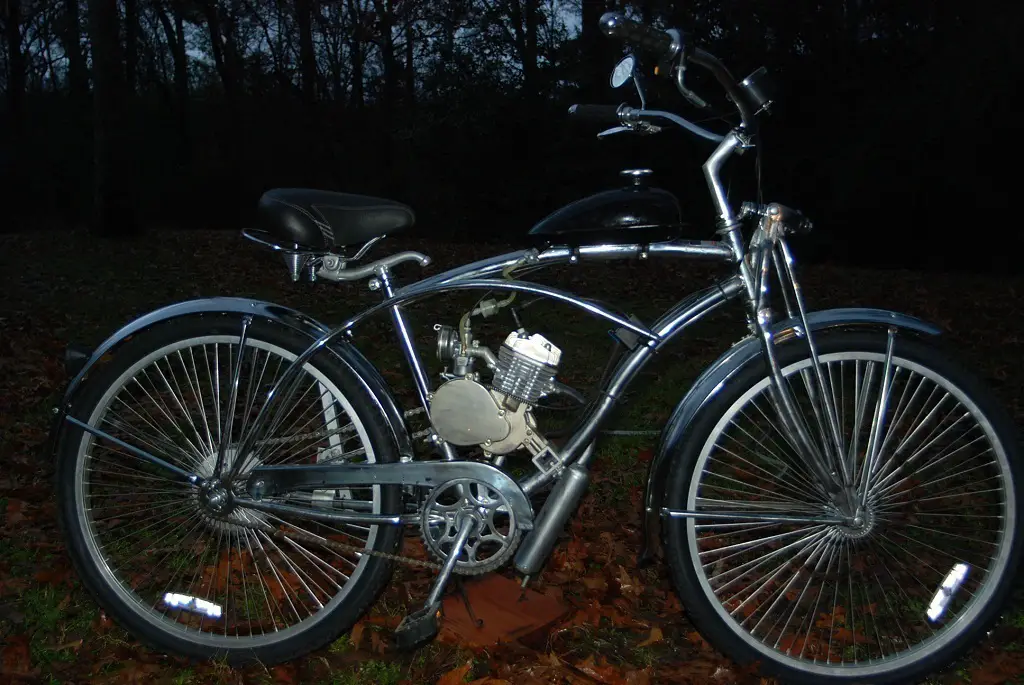

    I have a 49cc 4-stroke on my bike and it starts off the line with a brnot followed by a .wee. and just goes like a "bat outta hill" after that!!! :D
    Seriously......laff
