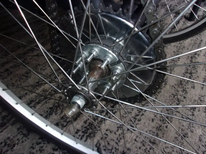

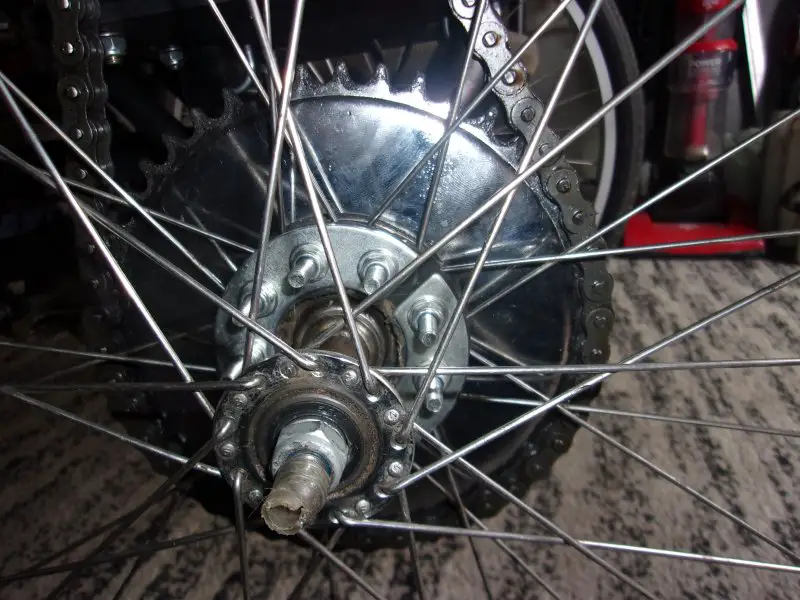

Are these sprockets universal for chain size? Every site I check just says sprocket 20 bucks but no info on what size chain it uses. Right now its running 415 chain and try finding a centrifugal clutch that uses 415 chain its pretty hard and none in stock.
Another question can some one tell me in an easy to understand chain sizes that will work on 415 sprockets every were I look just leaves me confused or again anything that is supposed to work they dont have a clutch for it. Better yet maybe someone knows better places to buy stuff that I havent found yet. Thanks for any and all help. PeteJ

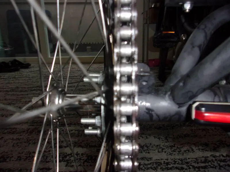

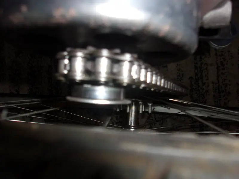

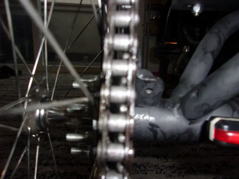

I have plenty of room cause no gear boxes anywhere near the chain. Never really paid attention till now but there is a lot of side by side slop in the 415 chain on both sprockets. Is that common? looks close to a 1/4 inch

The rear sprocket looks like it was made for the #410 chain, if the front sprocket is the same you could run heavy duty 410. Don't go cheap on chain, you need to buy good quality.
Once had a person who had a 410 in the rear and a 415 in the front. So I switched out the front engine sprocket to a 410. Heavy duty chain is a must.
