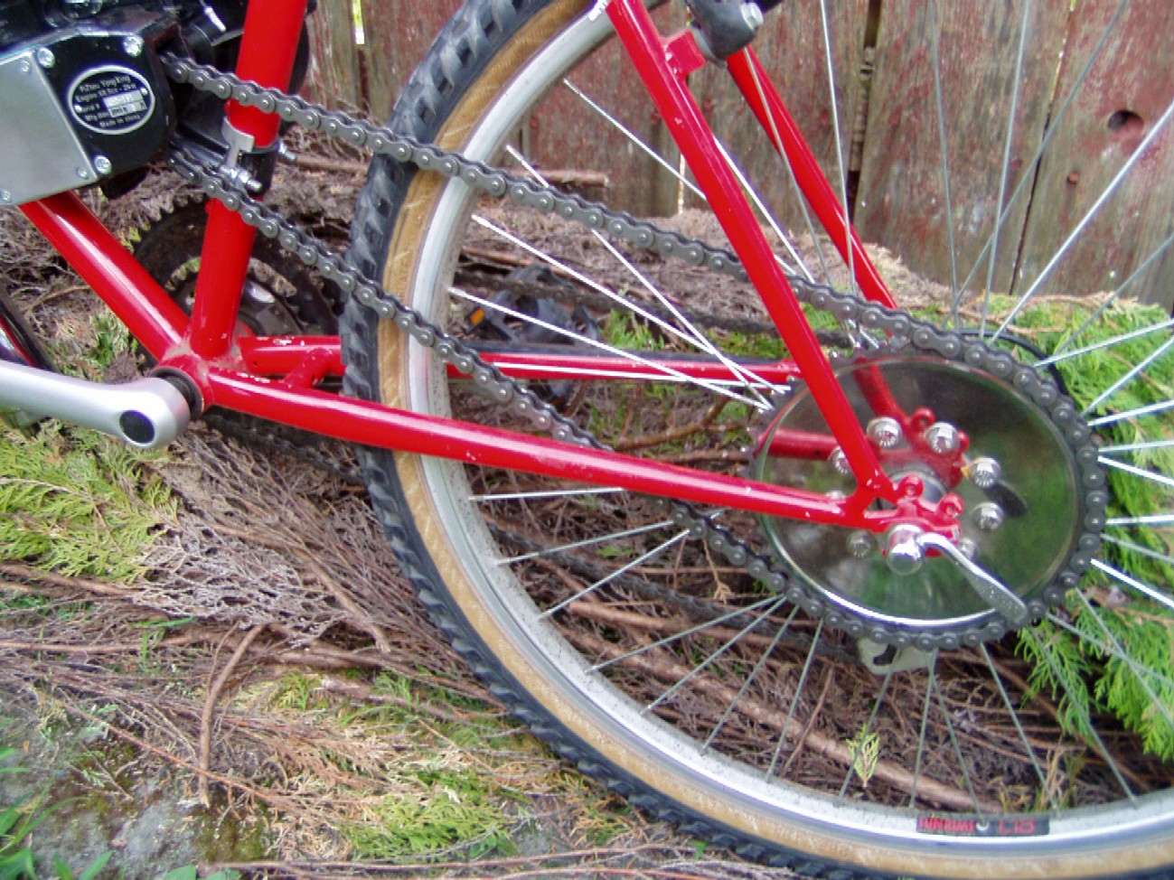

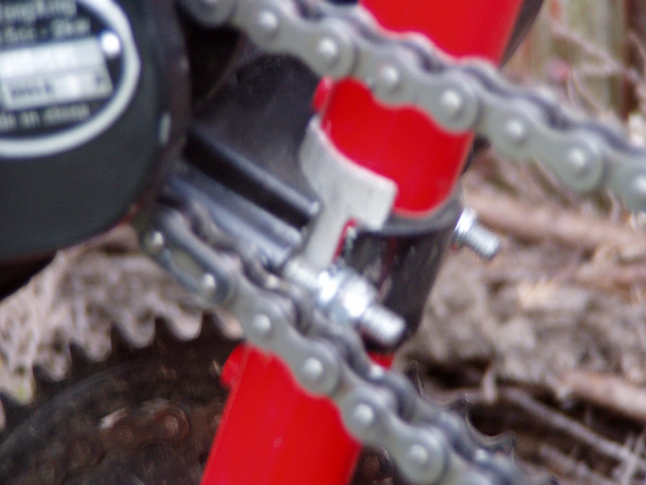

    Good Morning Forum members,
    I'm looking to purchase a spring-loaded chain tensioner. On my latest build I need (2), one for the slack in the top of the chain and one for the bottom. I can't make the chain any shorter.
    The last spring-loaded chain tensioner that I purchased was (I believe) from Sick Bike parts for about $24...I don't think they are selling them any longer.
    If any body has any sources for pre-built ones, I would greatly appreciate the link.
    Thanks again.

    Airbuzz, I am not sure what part of the country you live in but if you have a TSC, Tractor Supply in your area they make a nice little spring loaded tensioner thats works great for about $10.
    I just used one on my last build. I have made several different types, but it's not worth the time once I found these for $10.
    If you want more info. I will send you a pic. of it.

    I was looking for the tensioner cause I need the rubber wheel.. I have a livefast spring tensioner, but after trying to use it, a spring tensioner won't work because the tensioner has to be close to the sprocket to pull it to clear the chain stay... anyway, I saw 9.99 on the shelf but they were out of stock when I went :( when my stock tensioner got ate the 1st time it damaged the good bearing idler wheel, leaving me with the crap 1 from the spring tensioner..

    While building my new 4 stroke onto my Gary Fischer bike I got bike to the point of test drive,all was good but thought how awful the idler tensioner was with its smooth plastic wheel I never saw it spin,and now after buying bike upgrades,handle bars,wide seat and such, when reassembling tensioner ,upon tightening ,bolt snaps in two.Since I felt the part was so cheap to begin with I didn't want to pay $6 with $17 shipping for crap so have found this one,here is the link I will try to make it work,my chain is #410 and this says its for a #41,is this the same thing except they just don't bother to use the zero.Any expert thought here ,greatly appreciated Sprocket Idler

    I did something similar. On the rear mount, I added a nut on each stud as a spacer between the engine and the tube clamp. I took out a couple of links (a half link would give you a little more flexibility), moved the rear axle, and was good to go .
    120 miles on it so far and the chain seems fine.
