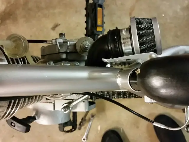

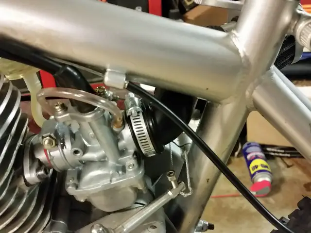

    You'll probably like it once you get it to seal on the manifold well. Mine is a bit on the rich side with the stock main jet in it so I got some smaller ones to dial it in with. I hadn't swapped the jets out yet today since my air filter duct came in. Since this carb is a PW80 clone I ordered up a PW80 carb inlet duct since it's just the right size and shape to let me run an air filter in my tight frame... I'm really happy with the way it fits and looks, but may need to make up a support bracket for the filter since it can flex pretty far on it's own...

    Looks good, should be easy to make a simple support to stop the filter from bouncing around, being a somewhat Redneck country boy type as myself mine may not look fancy but I'd have something rigged up pretty quick for that...lol!

    Lol... thanks, I think I can just weld a small tab somewhere close for the clamp to grab onto, that'll keep it from flexing... I still need to do a few more weld jobs on the frame to support my pipe better anyway then I'll be able to take it all apart and paint this thing...

    For a simple 'temp' fix, you could loosen the hose clamp that secures the filter, slip a small black zip tie under the clamp, and then just 'zip' it to the down tube.
    High tech Redneck at it's finest!!

    Hehehe... Look at teh pics of my air filter closer and I'm sure you'll find a ziptie in there... I got some redneck engineering going on in my build too...

    Oops... forgot to mention there's also a 1 1/2" long section of 1" diameter pvd pipe that I cut a groove in on my lathe inside between the filter and the inlet duct to connect the 2 together, the clamp that holds the filter on was too wide for the groove on the duct so the filter got the clamp and the duct it's self got a black zip tie...

    looks plenty good there Dave...
