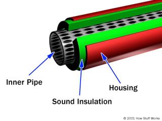

    Two strokes need some back pressure to run properly, they need tuned back pressure for performance - problem is most expansion chambers go with the "louder must be better" theory and that can get annoying - but easily fixed. Of the available expansion chambers most don't have any silencing at all, but some do and the best for performance and noise reduction both have a glasspack silencer on the end.
    [​IMG]
    As you can see from the pic, there's no baffles, no screens or plates - the exhaust can freely flow through the inner pipe as the fiberglass sound insulation absorbs some of the shock wave, deadening the "bang" much like a gun silencer. The only downside is the fiberglass batting will load up with carbon and unburned oil in time, needing to be repacked periodically. Not really a big problem though as regular old household insulation fiberglass will do just fine and it's usually only four pop-rivets or screws to get it apart.
    I took the SBP's expansion chamber exhaust and doubled the length of it's glasspack silencer, it's now just a little quieter than stock at half throttle or less - it wakes up and gets louder only at WOT, which is exactly how I like it lol;
