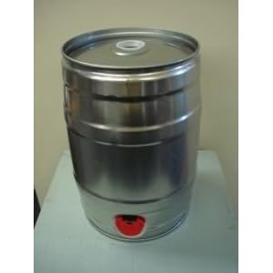

    [​IMG]
    5 liter party Keg fit with a spigot and bung with a cap and mount behind the seat where your knees wont hit it?
