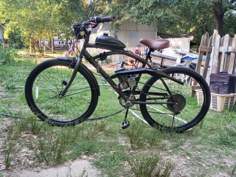

Here's what's happening...
I set my clutch and it's working fine then few days or so later my clutch is to tight to disengage.
My flower nut set screw is tight and there's no change or adjustment done to my clutch system but all on its own it tightens up and I have to reset my flower nut againalso this not just to tight using the clutch cable but even if I manually push the clutch arm all the way back, side note my flowernut set screw isn't the original but one I found to fit.
Any ideas or suggestions
