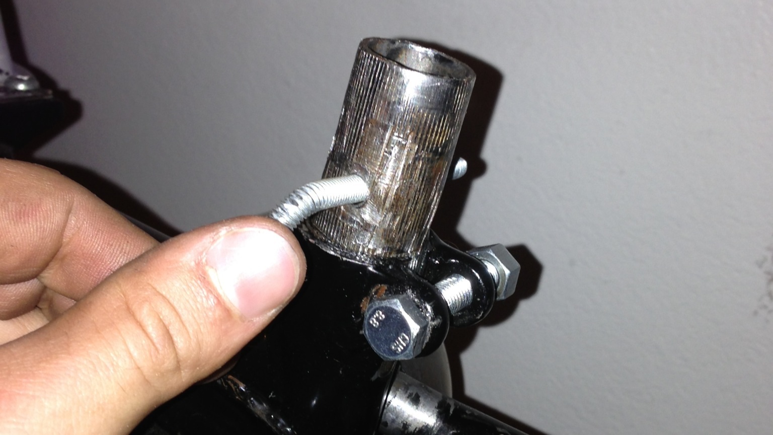

    Got a pretty sweet bike in a trade, but the guy before me stupidly wedged a spacer into a seat post tube and now I can't get it out. Any ideas?

    What you see in the pic is an aluminum tube with ridges. I tried to get some silicone grease in between the seat tube and that aluminum tub then gripping it with a clamp and then hitting it with a hammer from the bottom. Tried heating it as well. It's in a good 5-6 inches and is just not budging.

    Don't have a welder, what about drilling a hole through it, putting a large rod through that hole then banging it with a hammer?

    This is not happening

    Way too small a rod. Try using an old socket extention. Much less likely to bend. Wear safety glasses though, it could possibly shatter.
