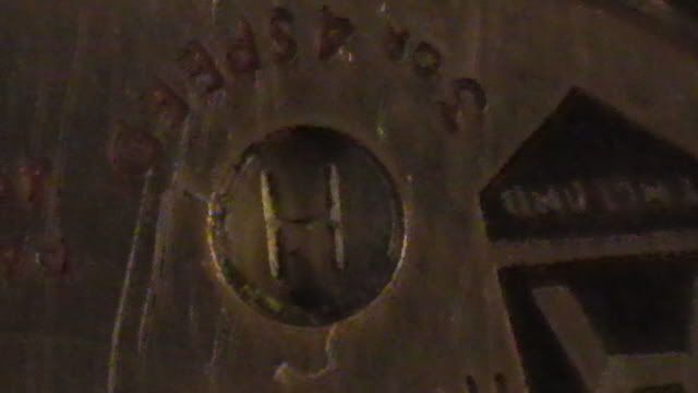

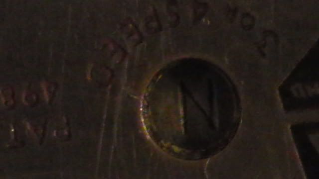

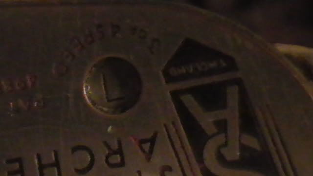

    I can make out what appears to be an "H" then it says "N" then it says "L" and when I put it on "N" position the wheel just spins . Wait I will just take a photo's of it. Intrepid I called on the Coppers they said there were no reports of it stolen, I then told them I was thinking of taking it they said "thanks for removing the trash" If anyone reports it they have my number
    The rear hub says on it Sturmey Archer below that is the letters A.W. Below that is a 53 to the right of the 53 is a 5 Is this like the Schwinn badges can I assume this bike was built in May of 1953? Every thing on it points to that era

    Intrepid WheelwomanOn the shifter I see an "H" an "N" and an "L" Can you see them in the photo I cleaned out the hub until clean oil started coming out & no more black junk was left in it now I am getting nice solid clicks when shifting and when it is on the "N" position it spins freely as if its neutraL IT SEEMS. also there are only two gears I cant find the third?. Whats up with that? Intrepid Dids you see the pictures of the shifter and the letters in the tiny hole I cleaned them up with a q-tip clearly they read H -N-L if this is indeed the case I wonder how how many were made?

    The "N" may have originally stood for neutral, not like a car where the drive unit is disengaged but more like a neutral gear ratio with a ratio higher (H) and 1 ratio lower (L). Just think of the N as "normal". When your cable is adjusted properly the slip or what you refer to as neutral will be between 2nd and 3rd gear.

    OK so its "H" for High gear "L" for Low gear and "N" for Normal gear ? OK good thank you very much for helping me out

    I've been doing a fair bit of searching into Sturmey Archer gearhub history and it seems that the 'AW' hub was indeed a 3 speed and never a 2 speed. The earlier 1950s hubs do use the 'Low, Normal, High' designation (including the clone hubs made under licence by Hercules and others). Later on the gears were marked as being '1,2,3'. There was a way to convert an 'AW' hub into a 'fixed' (no freewheel) two speed, however this was not a factory offering, but an enthusiasts' clever conversion.
    The only two speed hubs made by Sturmey Archer were the two speed 'kickback' hubs (with or without coaster brake) made in the 1960s.
    If adjusting the cable doesn't make the middle gear position work you may need to open up the hub and do a little repair work. I have done this in the past myself and it's not as terrible a task as it might sound.
