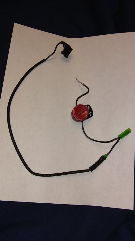

I just went through this with mine. The only wire you need is the black wire to kill the engine, remove the box and unplug it. I took off the side cover to get all of the governor parts out. I think the main issue you'll have is oil leaking around where the yellow wire comes out. Did you get the washer out of your engine from the governor post? There's a washer behind the plastic governor gear also. I think removing the shut off parts inside will help the oil splash around better. There's a few ways to plug the hole.
