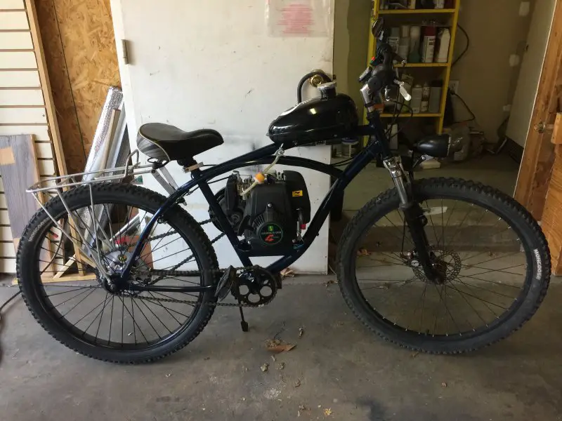

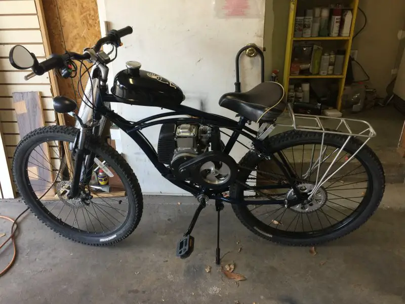

    I have a Cranbrook and have not had any issues with some of the parts that people talk about. I did disassembled the rear hub, clean, and re grease it. I built mine from several use bikes I purchase from second hand stores. I ride mine regularly and have had no issue. I don't go off road, try to avoid potholes, and try not to overuse the rear coaster brake. I have mountain bike forks on the Cranbrook with disk brakes and they definitely ride smoother than the springer forks on my Roadmaster. The Roadmaster frame is longer and handles better, it also has Sturmey archer drum brakes on the front which seems to work better, but just might be my imagination. A lot of these options will work well and just come down to preference and how much you are willing to spend. You definitely want to be able to stop and you want to be seen, so don't forget lighting. Here are pics of 2 of my bikes.
