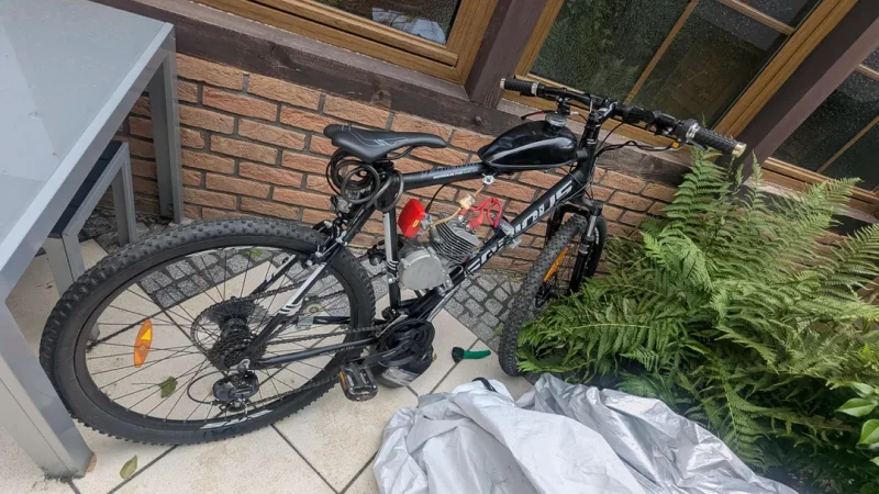

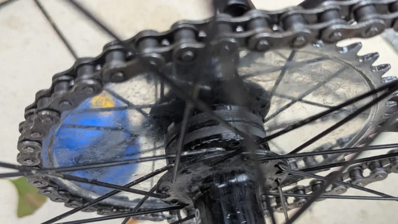

Hello friends of motorized bicycles, I am new in this and just built my second bike. I have a little problem. My chain is always jumping off. It's because i mounted my sprocket (aftermarket part) directly where usually the disc brake is installed and it protrudes more than the motor pinion. (Picture 1 & 2)

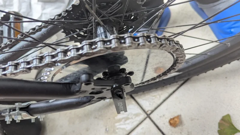

-contra: I can't adjust the adapter (maybe a bit to the outside adding washers between the disc brake attachment and the adapter) (Picture 3)
