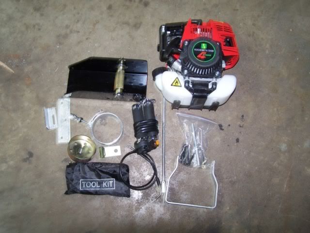

    Hi I have a 31cc 4 cycle engine on a friction kit.
    ? one the inside of the clutch housing has been worn smooth, is there any benefit, to roughing it up, or is smooth just the nature of the beast.
    Next is the oil, the instructions did not say and the with the dip stick
    Would you measure the oil as the stick is unscrewed slide in and out and measure, or screw in and and then out. it only has about 3.5 oz of oil when filled to the point where I can see it at the bottom of the tube and sloshing back and forth to see it.
    Even with it unscrewed the mark seems to low for it to be right, China tech ya know....
    I do not want to over fill or under fill this lil motor
    this reads badly for that I am sorry.
    [​IMG]
    This is the engine, I hope this works
    Thanks and happy biking!

    If you are referring to the inside of the clutch bell, smooth is normal.
    If it were my engine I would do everything I could to find a manual for it on the internet.
    That said, nearly all dip sticks are supposed to be dipped. Do not screw it in to take a reading, just "dip" it into the hole until it stops, no threading it in, then pull it out and read the level.

    I find it hard to believe that is your motor being I am the one that took that picture!!!
    one quart will last about 4 oil changes in theses little motors so 3.5 to 4 ounces is about right. If you rough up the clutch bell you will tear the friction pads right off the clutch.

    Yank That is the type of motor...
    Thanks for the input.
