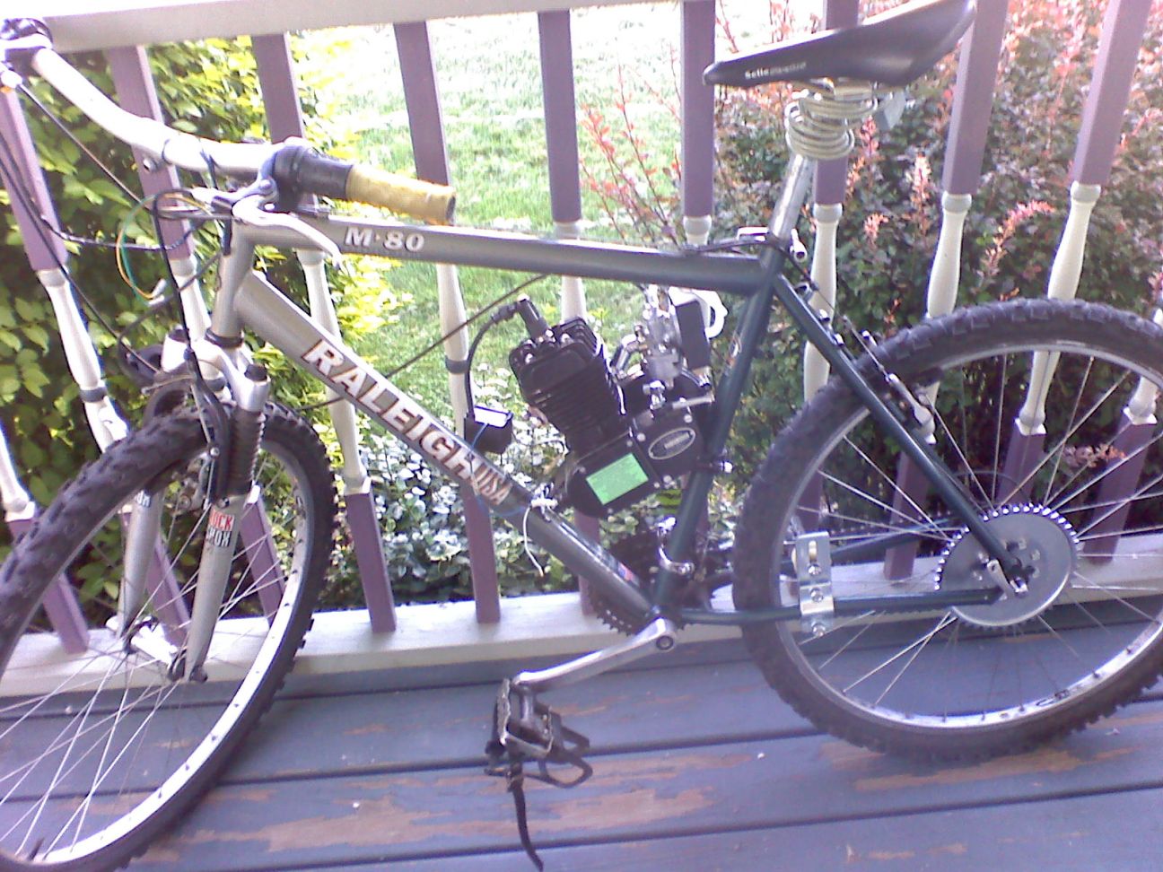

    Side covers....

    DOOOOOD... you need lots of air flowing over the engine or it will burn up!
    (that's why they're called 'air cooled')

    ...but if those plates are just covering the sides of the engine there should be no problem. Just keep the front and back open so the cylinder will catch some wind when you are riding.

    Take a look at this picture...you'll see that the air gets thru plenty, straight thru and out the back. I have ridden this at the end of summer when we had some warm days and I can leave this thing idling for a while without heat buildup. I crank the throttle full doing full speed for long distance and no heat buildup other than usual. These motors aren't as fragile to temperature as you think. I formed the panels to have a inward "c" type flanges top and bottom for rigidity.

    The intake is fine and there is no noticable change between having the panels or not. The only change that is noticable is when it is below 40 degrees outside with full throttle. The airflow is hardly changed with the thru flow design...You'd be surprised at how little heat there is on this setup.

    I noticed an improvement in noise reduction just with the panels. I tried some foam in a few areas to see what kind of dampening I would get. I have a feeling that if I get some self-adhesive weather strip and place it along the inside edges all around, I will see less vibration on the outside edges. The vibration with out dampening isn't that bad, but every little bit helps when quieting these motors. A different intake setup is my latest endeavor. I'll be ever-tinkering with this thing...as you know, perfection takes time.
