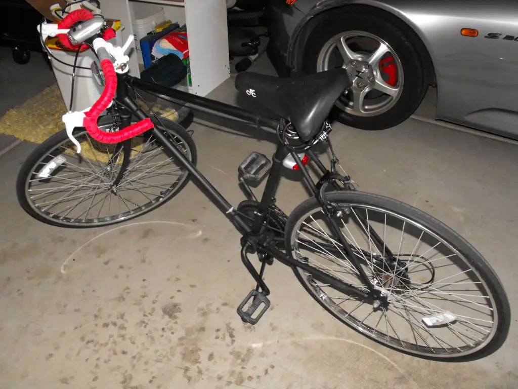

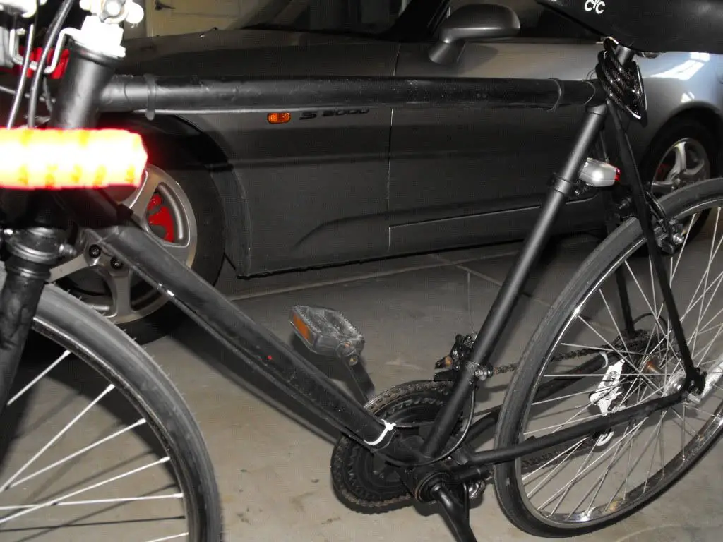

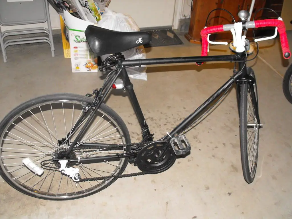

    LASTLY, here's a few photos of my bicycle. UNFORTUNATELY, I do not know the specific dimensions, but from the looks of the photos, do you think I would have any problems? Thank you!

    Well first off the handlebars gotta go(I wouldnt us them anyways) I like a more solid bike for my builds....It might just be fine,but never tried it with those skinny wheels and tires....If im not mistaken kingsmotorbikes is boygofast,someone can correct me if im wrong....I bought a engine from boygofast and have had no problems with it so far(still in the break in period)....from there I have heard good and bad about both....It what everyone calls a crapshoot around here....you could get lucky and get a great engine or a bad one,the the thing is customer service....If you get a bad motor you want to be able to exchange it and have someone that will take care of you like thatsdax.com....He will take care of any problem you may have....I have not bought from zone8cycling but they offer a 6month warranty on there Raw engine for 148.00 shipped to your door....I talked to bikeberry on the phone and they told me they have the 6 month warranty but if any thing is wrong with your engine you have to tear it down and find the part that is wrong with it and they would send you the new part....I thought no way,that is not a warranty if I have to tear the engine down I will just buy somewere else....That was the end of the conversation I had with the guy....He might have been new and didnt know what he was talking about....

  3. Kevlarr
    Kevlarr New Member
    Joined:
    Jul 22, 2009
    Messages:
    1,628
    Likes Received:
    That looks to be the same huge frame that my Schwinn Timberline MTB has. I have a Schwinn High Plains too and the frame is about 8" smaller.
    I'd definitely look for a cheap used MTB to steal the handlebars, shifters, front shock forks, wheels tires off from. Those skinny tires will make for a very harsh ride @ 30 mph.
  4. wheelbender6
    wheelbender6 Active Member
    Joined:
    Sep 4, 2008
    Messages:
    3,824
    Likes Received:
    12
    I think the road bike is fine with MTB or cruiser handlebars. Keep those thin tires pumped up and your OK.
    I know you have the pull bars attached to the road bike brakes that allow you to brake with yours hand up on the cross bar. However, the pull bars do not provide full braking power that allows you to avoid accidents at 25 mph.

    Should I just replace my pull-bars with standard bicycle braking grips then while I'm in the process of changing the handlebars?

    I'm going to play with the suspension once the engine is installed and move from there. For now, I want to focus on the necessary changes to create a simple motorized bicycle. Thanks though. I'll definitely keep that in mind post-engine installation.

    Either motor should work.
    You will have problems mounting a motor due to the location of the front derailleur but you might be able to work around it. Narrow tires will make for a rougher ride. Not only do you feel the road more, but you will feel the motor more. One of my MB's has narrow tires and you definitely feel the vibrations more. If your journey's are short, this isn't too much of an issue. You can buy wider tires to help offset this. Some may disagree, but in my opinion these motors like cruisers more. Three of the four MBs I built are cruisers and almost everyone prefers those.

    Where is the "front derailleur"?

    The dohicky (technical term, I know) right above the front chain ring that switches gears for the front. Bottom part of the seat tube, right above the bottom bracket. That thingamajig is right about where the rear motor mount will clamp to the seat tube so it's possible it will get in your way. If it does, just put the chain on the big ring and remove the derailleur as you won't be shifting anyway. You only need enough gear to get going and then the motor will do the rest.

    I think that bike is going to beat you to death along with tons of flats....When you get an engine on it let me how she rides....I might be wrong and it will be ok,but in my experience you have to have heavy duty rims 26x2.25 (12 gage spokes to keep from getting bent rims)with some fat tires for comfort....

    I second that. I switched to mountain bikes after countless flats and more than a few bent rims.
    Skinny 10 speeds worked ok for my small friction motors (27cc-33cc) but too fragile for the speed and weight of HTs. If it's all you have and you ride carefully they do work and have advantage of easy install.
