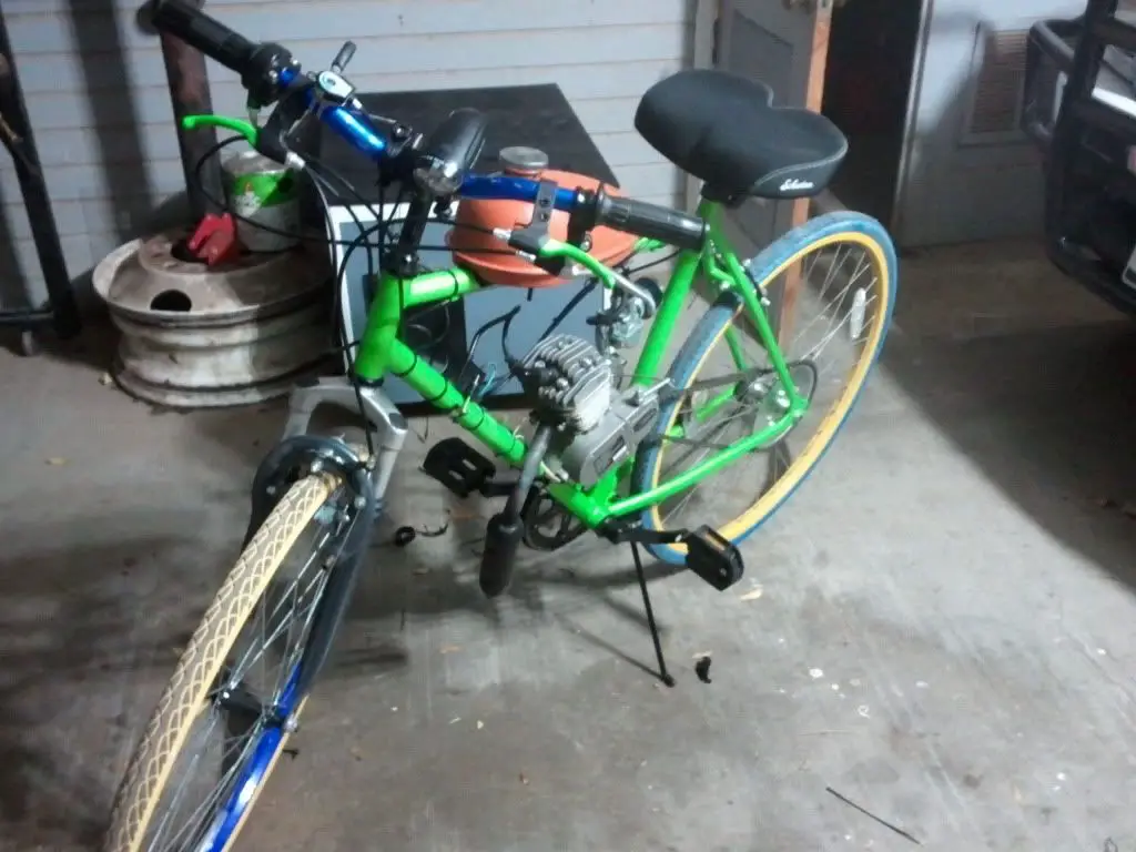

    I just built me one with the exact same bike. My colors were a little brighter though. This looked like the easiest bike in the world to motorize.
    [​IMG] I yanked a fork with shocks off another bike, it really helps alot on bumpy roads.

    Nice bike. Mine is the stock walmart one. its gets a little bumpy but not bad. I replaced all gaskets except the clutch one. Figured the cardboard wouldn't hold up. Especially since once I put on the muffler bracket it moved it slightly and made it leak.
    trying to put a picture up but computer is being dumb....
