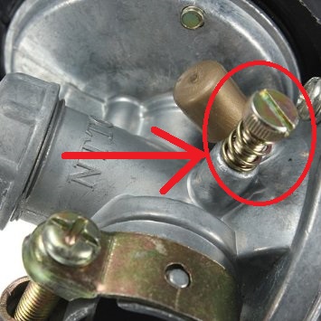

    Hey mates,
    The small gold bolt with the spring in the picture, located on the carburetor fell off the other day. What would the name of that bolt and spring be listed as online to purchase a replacement?
    Also, does anyone know if a small engine store in town would probably carry it? Or even somewhere as convenient as lowes?
    Thanks ahead of time,
    Spencer:-||

    Upon further research.. would it be referred to as the idle screw and spring? I think Im beginning to answer my own question.. .trlrl.

    I think that these carbs are so cheap, you should just buy a new one; they can be had for about $15 delivered.

    If you have a small engine repair shop in town then yes, take the carb with you and they will likely have a screw to fit. good luck

    That carburetor rebuild kit won't do you any good. The parts aren't for the NT carb.
    The missing screw is not a needle type like mixture screws. It is blunt on the end and acts as a mechanical stop to adjust engine idle speed. I don't know of any suppliers that sell just that part. They can be made but you'd need one to copy. The length is critical as is the diameter of the end that goes in the throttle slide bore.
    I'd order a new carb and have spare parts. You'll want to order and NT carburetor for an exact replacement. Some other aftermarket carbs will require a different throttle cable.
