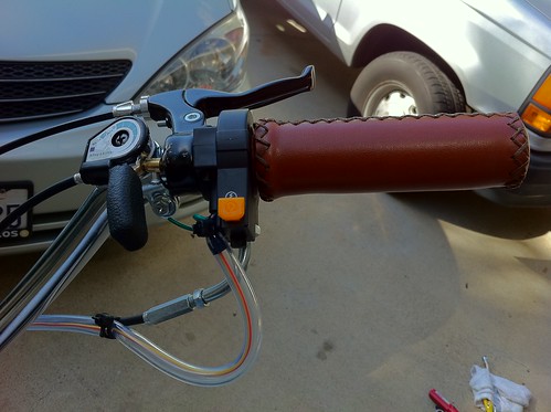

    Love the thumb throttle. How do like that carb? Did you try the stock carb first to compare? Overall your ride looks great!

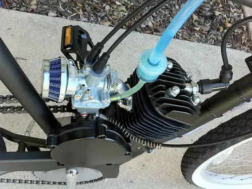

    I'm not sure,but "DO NOT" turn this filter over now as it will dump collected dirt into the carb.tube ,,,but the filter looks up-side down ,it should be on so that the dirt collects on the outside of the filter paper so you can see it

    Umm thats the bar mounted choke lever.

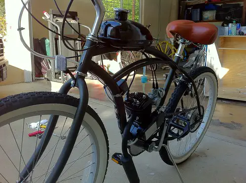

    beautiful bike. you asked for suggestions so here goes:
    remove reflectors (looks)
    replace fuel line with a quality black hose (functional/looks)
    other than that it looks great.

    I agree that it does look good but now you need to make it a litttle more personable. Laid back seat post , crazy handlebars , custom gas tank , something for the wow factor and to make it stand out.

    The biggest thing IMO is when a bike has nice short length cable housings and tight wireing... long loop cables look like heck...
    Id paint the tank to match the frame .....

    I got the CNS Carb from GasBike.net. It comes with the air filter, but I would only recommend this carb to someone who has experience tunning, or has A LOT available to learn how. Thanks for the recommendation on tank paint. I never thought about a grain wood look, but I really like the idea and I'm going to go for it!

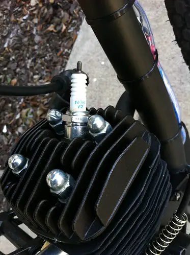

    the head ,get some shoulder nuts ,use a piece of sand paper on a piece of glass to level the head,if the gasket is not damaged ,put it back togeather,AND I think the head torque is ONLY 12 foot pounds,its is very little
