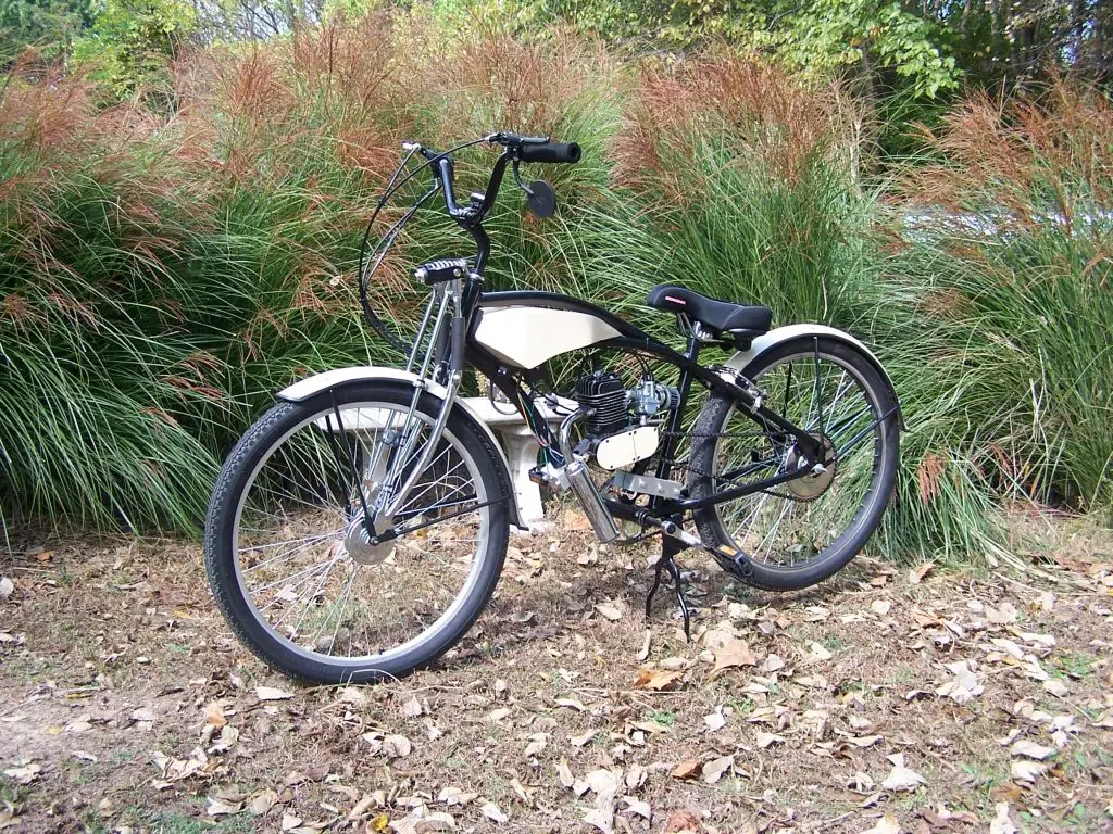

    I Finally got her up and running the other day and thought I would share some pics.
    Pic#1: As you can see I was going for the vintage look.
    Pic#2: I had to get creative with my engine mounts. Those are 1 1/2" thick blocks of aluminum, bored out and then split and bolted back together around the frame and a piece of steel tube. It's very solid.
    Pic#3: Also, I know that there is a lot of worry about front fenders falling off and locking up the front wheel. This is what I came up with. Those are cushion clamps and they are available in different sizes at almost any hardware store.
    This bike isn't really done, they never are right? Over the next few months I plan to add an SBP expansion chamber, old-timey leather seat and tool bag, and possibly do something different with the handle bars. Also, I'm not that happy with the tank, so the first order of business is to build a new one and make it out of fiberglass this time. I'm much better at fiberglassing than welding.

    Pretty nice work. I do like your fender clamp idea. How much does a big block of aluminiun like that cost? Could you post a close up pic of the front motor mount?

    Likes Received:
    looks very nice !!!
    that is a very stout mount ;)
    the fender fix is pretty cool as well :)

    Did you make the tank Tim? If not where did you find that tank just curious. It does work nicely with that frame.

    Biknut, I think that a block of aluminum that size would be around $12. I got mine for free, I told my Dad what I intended to do and some blocks of aluminum "disappeared" from where he works. ;)
    Also, I will get the camera out shortly for that close up pic.
    Goat Herder, Yes I made the tank. Like I said before, I am no welder. Actually the tank is brazed together, but the problem is that it leaks despite the fact that I used Kreme on it. I wanted to do a fiberglass tank, but everyone around me said OMG YOU SHOULDN'T DO THAT BECAUSE I DON'T KNOW ANYTHING ABOUT IT AND IT DOESN'T MATTER IF YOU DO BECAUSE I DON'T!!!!! so I made a metal one... and it leaks. LOL, so I'm doing it my way next time. :)
