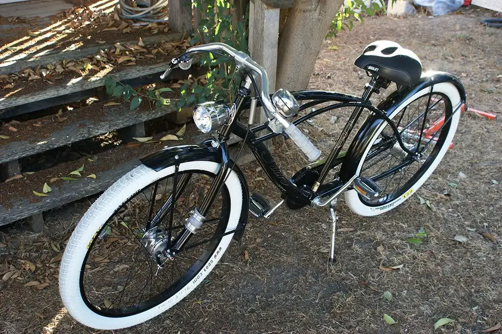

    hello forum! i am new here and workin on my first motorbike project. this is what i have put together so far. i have a sun custom retro cruiser. i had 2 wheels built around a sturmey archer x-fd front drum brake and the matching sturmey 3speed drum for the rear. i am using a problemsolvers cable doubler to pull both brakes with a right hand lever. the next step is to find a nice 2 stroke and a shifter kit. im also thinking about going with board racer style bars and a monarch front. i am open to any wisdom or advice for this project. this is an awesome forum by the way!

    Glad to have you! The bike already has a classic look, will be a great looking MB, In my opinion, don't paint the motor black, the silver painted motor would look very cool on that classic looking bike, and set off the mechanical reality of the motor, just my opinion, but what ever you decide, its your girl, and I am sure she will come out looking great. Keep us posted on your progress.

    Lookin' good already no doubt (^)
    FYI - I'm runnin the same Sturmey Archer hubs and the three speed is holdin' up really well to the SBP Deluxe HD Shifter Kit II, although you may find the axle nuts difficult to tighten adequately w/o stripping them to prevent movement in the dropouts. The problem is the flats on the axle (to prevent rotation) effectively reduces the threaded area by about 1/2 & there's just not enough surface area to hold under hard acceleration. It's not a fatal problem, just annoying when ya drop a gear and punch it to pass some spandexer and promptly derail the chain as the rear sprocket is a lil crooked now :p
    While my bike came equipped with dropout tensioners, you may wish to consider something like this as a solution: Bikeman: MKS Track Dropout Tensioners, for 5mm Dropouts (but I dunno yer axle shaft & dropout sizes so better chk them bfore ordering).
    I'd also advise usin' a drop o'loctite on the Sturmey's cable tension adjusters - I spaced that and paid the price of five spokes ripped outa my front wheel o_O Fortunately I was puttin' along at about a walking speed at the time lol
    That's such a sweet lookin' ride already man - I can't wait to see where ya go from here :D
    Oh right - oddly, the Sturmey 3sp seems geared a lil tall with the shiftkit (the shiftkit gearing was with a 21sp bike in mind), I'm running the 10T (standard, comes w/kit) jackshaft to crank sprocket (lil one on right side) with the 48T chainring (kit comes w/the 44T): Chainring - Freewheel - 48 Tooth w/chain guard and that seems about perfect for my ride... which is a bit of a heavy bike *shrug*

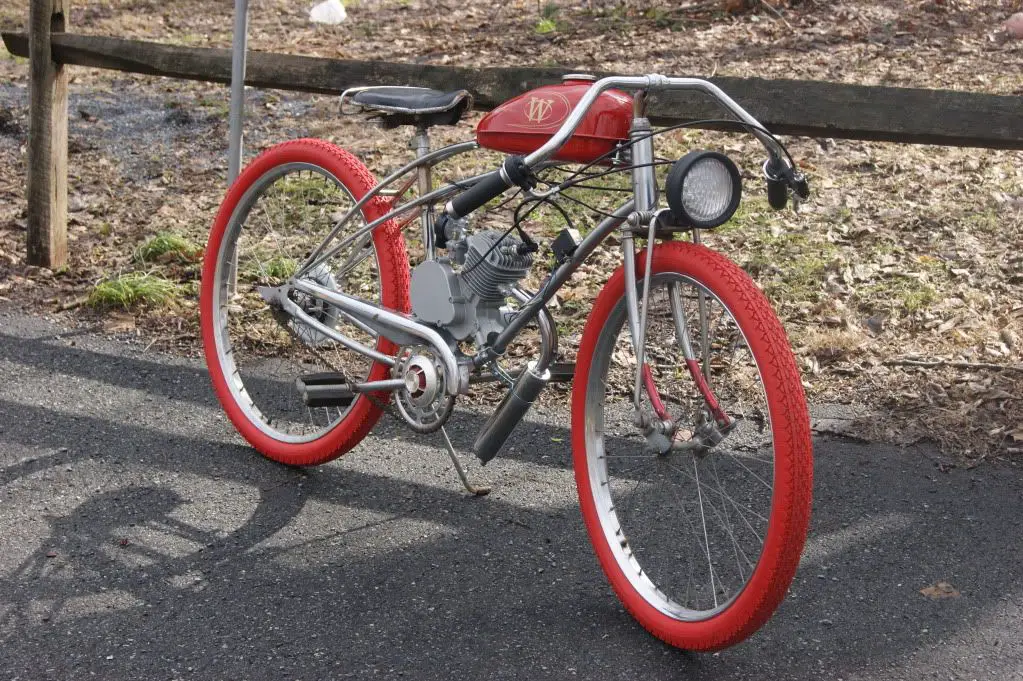

  16. mykustomcruizer
    mykustomcruizer New Member
    Joined:
    May 16, 2010
    Messages:
    91
    Likes Received:
    i would go on ebay theres a guy who sell repro whizzer tanks there very nice and alot bigger then the cheap little ones
    [​IMG]
  17. driftology
    driftology New Member
    Joined:
    Jun 22, 2010
    Messages:
    125
    Likes Received:
    Your bike is sweet! I love the color. What throttle is that?
  18. mykustomcruizer
    Joined:
    May 16, 2010
    Messages:
    91
    Likes Received:
    came with the kit i bought from ebay i really do like them
