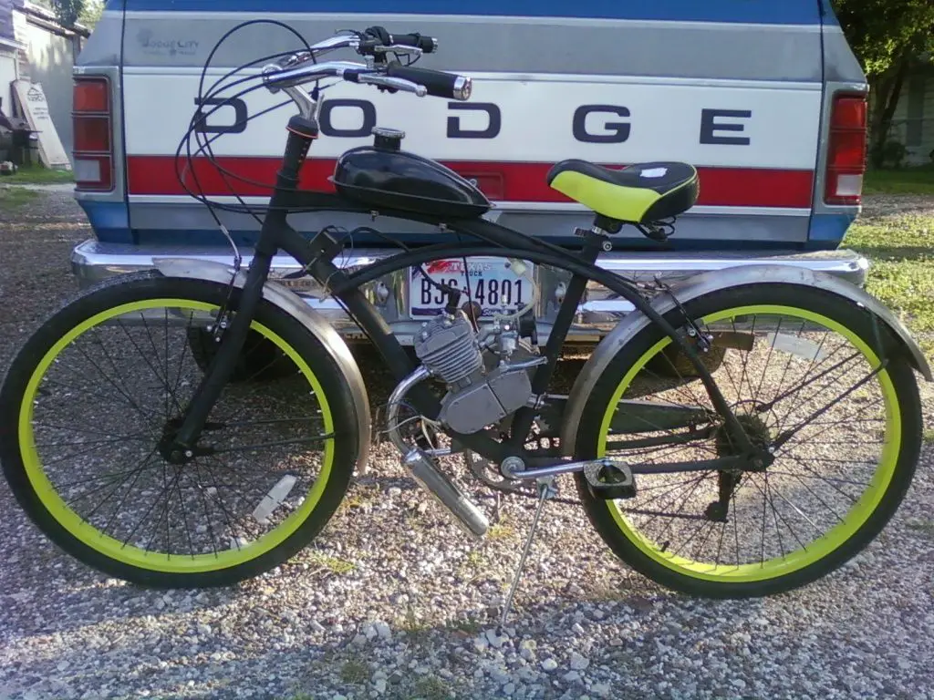

    Hello All! I have not been on here for quite some time! Last time I was on here I was making weed eater friction drive bmx bikes but I grew tired of them and decided to make myself a cruiser bike. I really lucked out with this as I found it at the pawn shop with the motor and gas tank already on it! There was no coil, throttle, kill switch, chain or wheel hub on it, but I am just waiting for the last of my parts to come in so I can get her on the road. The coil, throttle and kill switch came in quite fast, but I am still waiting on my chain, hub and tensioner. I only paid $200 for this! It has never ran or seen fuel! I am really excited to finish this and show you all the end result. Hope ya'll like it so far.
    [​IMG]

    Nice looking bike you have there. Keep us posted on how it rides.

    Howdy Recreative. $200 is a good score!
    Just a thought, those fenders need some shoring up.

    It looks to be a great bargain for the money spent.
    Congrats!

    Ha, that paint is pretty cool looking! You gonna tie the engine into it somehow?

    great looking bike!

    Looks awesome, nice build

    Well, thanks everyone! I couldn't pass it up being only 200 and so far I have only spent 45 dollars in parts. I finally have it all set up and ready to do a test ride. I have one concern so far though, it feels as if the 415 chain snags every so often on the engine sprocket. Should I maybe file the teeth down a bit? Other than that, everything else seems to be fine. I did shore up those fenders too. I just hope the rubber washers I use help out enough with vibration. I can't wait to get off from work and go take her for a spin. Maybe I should name her?
