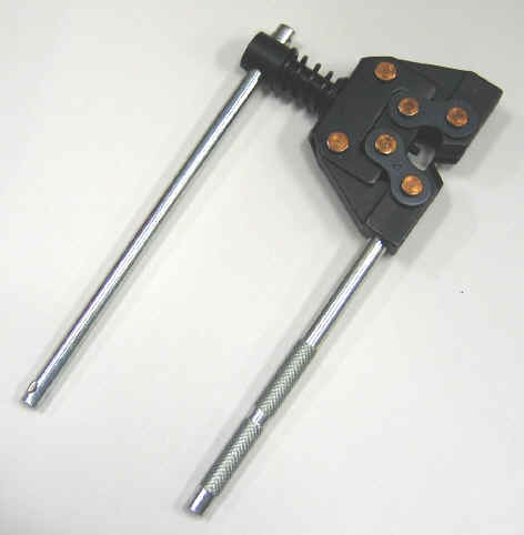

    i have this:
    [​IMG]
    now how do i use it, i only found a HOW TO video on a different kind of chain "breaker" that just removes the hinges without destroying anything. did i buy the wrong tool?

    The instructions are on the back of the cardboard that the tool came on. But I assume you didn't get that or you wouldn't be asking. The bar that goes into the jaw will open the jaws when pushed down. Put the chain in the open jaws being sure that the link pin is lined up with the part that pushes out the pin. Close the jaws by releasing that bar you pushed down. Then all you have to do is turn the other bar to push out the pin.
    I have the exact tool and it is actually made for motorcycle chains. A much bigger chain. But for us it is VERY heavy duty and it works great!
    Terry

    A picture is worth a thousand words. Or in my case a little fewer! Thanks for posting the pic!

    How do you put the cahin back together? I managed to just beat the hsit out of it til it went back together.

    flip the chain over and push the pin back with the breaker

    make sure the pin in the tool is not bigger than the pin u r trying to push or u will destroy that link in the chain

    yeah already destroyed the tool. stripped it.

    BTW, if ya remove the link pin driver, it also serves quite well as a mini-puller - like removing the clutch arm from it's splined shaft (to turn it in a spline or two to help prevent catching on the ol' pantleg) ;)
