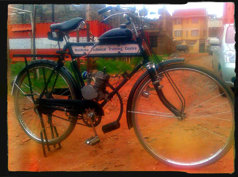

    Here's a photo of the finished bike in the sun.
    http://www.flickr.com/photos/michisunited/7746686080/in/set-72157629595539665
    What's left is the chain guard, and a better kill switch.

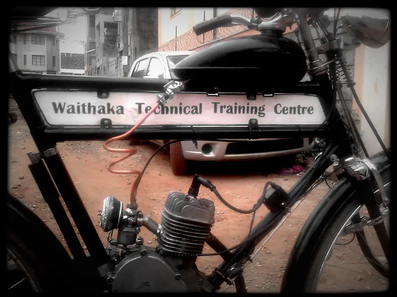

    Made a copper fuel pipe from some refrigeration pipe. Will try and make one with more loops but this one looks nice.
    Also made a new air filter from a soda can, so far it seems to run a lot better. Put a strip of the soda can between the manifold and the carb and the air leak also seems to be gone.
