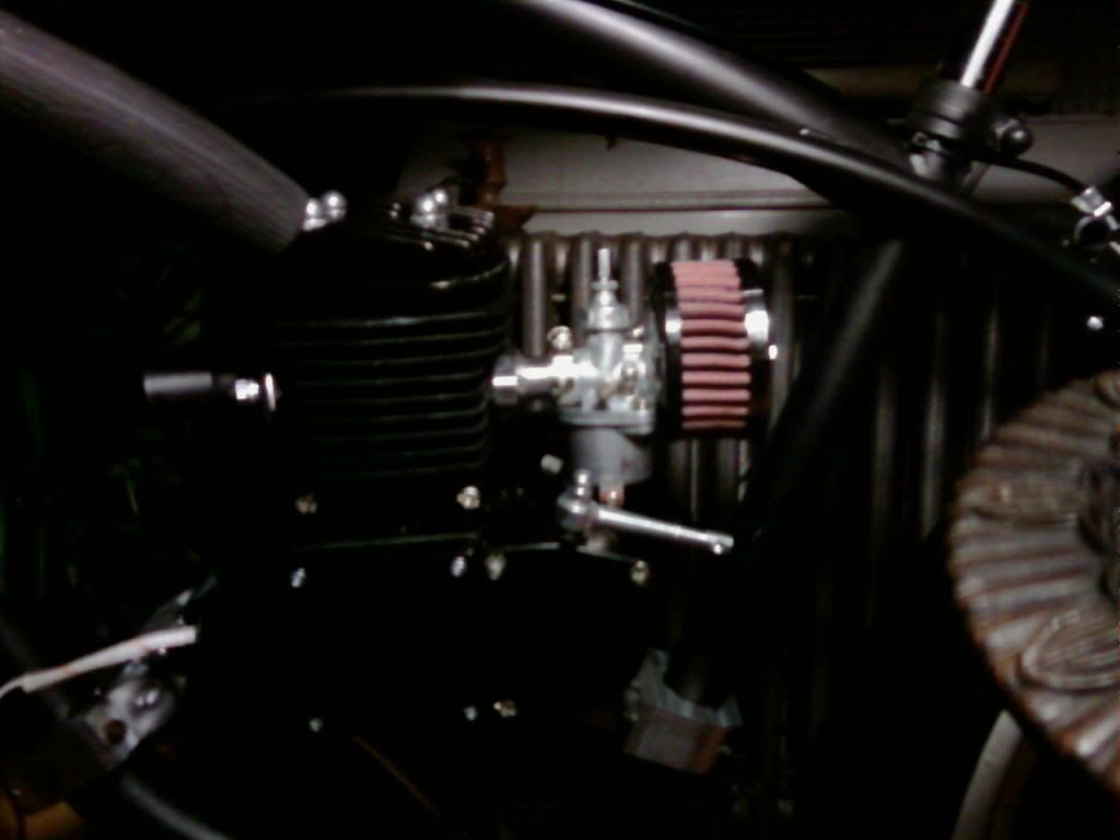

    I just started installing My kit (zb80) I have a M.M. intake but the clutch arm hits the carb not allowing the arm to be pulled all the way in. Pirates site says" Use of this intake will require that you remove the clutch Line Bolt and cut off a 1/4 inch of thread. Then replace." I am guessing the clutch line bolt is the one that the cable feeds through but I dont see how this will allow the arm full movement, anyone encountered this ? any suggestions?

    It is a strait arm... I can attach the cable to the arm with no interference from the carb I just wont be able to get it to pull all the way in without hitting this nipple with a screw in it on the bottom side of the bowl, clutch cover plate isnt coming off too easy the screw-bolt heads are already screwed they came kind of stripped out (whats the best way to remove them I don't want to return it becuase of that and they are out of stock) How far does that arm need to be able to come in ?

    [​IMG]
    Sorry about the crappy pictures, I have a 7 month vampire baby that will wake at the slightest bit of unnatural light in the house

    That clutch arm can be slightly re-clocked. There is a acorn nut on top of it. The arm sits on a set of splines. It is a bit of a bugger to pull off. Just re-clock it to a favorable position, and reattach the acorn nut.
    I was looking at your picture don't know about the m&m one just the China it may not be reclockable?

    I might have a older float bowl laying around without the drain screw... PM me your address & I'll send it (If I can find it).

    Don't bother changing out your bowl do as dude said above and pop off the clutch arm and re-position it on the splines. Sounds like one or two splines more to the outside will get you there bud.
