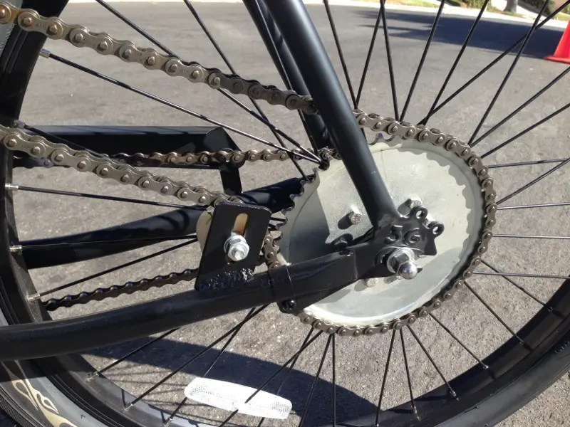

    As Tom said above, you must bend the bracket to make the wheel line up with the chain line & you also have to fasten the bracket to the frame so it will never move into the spokes!
    I always cut off the top of the bracket & weld it to the chain stay of the frame. ;)

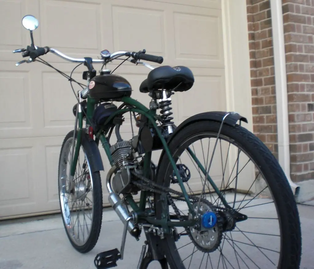

    This was taken at night time a couple days ago. I haven't been home in daylight long enough to work on things, let alone to take decent pictures.
    [​IMG]
    What you're seeing here is that I have cut the tensioner bracket and converted it to an exhaust hanger. And the shiny object above it is a wheel reflector.
    As far as spring tensioner go, the big thing I didn't think about when using one is that the top chain goes slack when you release the clutch. It tenses up the bottom chain and pull starts the engine. With enough slack... you could be coming to a grinding halt when the chain bunches up on the drive gear, or it just pops off completely and tangles around other stuff. It was a well though out design on my part (I was pretty proud of it actually). Unfortunately, it's just a bad idea. The skateboard wheel was my next choice, but I don't know of any skate shops around locally, and you apparently can't buy a single wheel online.
    I completely agree with the twisting of the tensioner bracket. I did that on all of my builds and never thought about it twice.

    Here's how I cut & weld the stock tensioner to the frame...

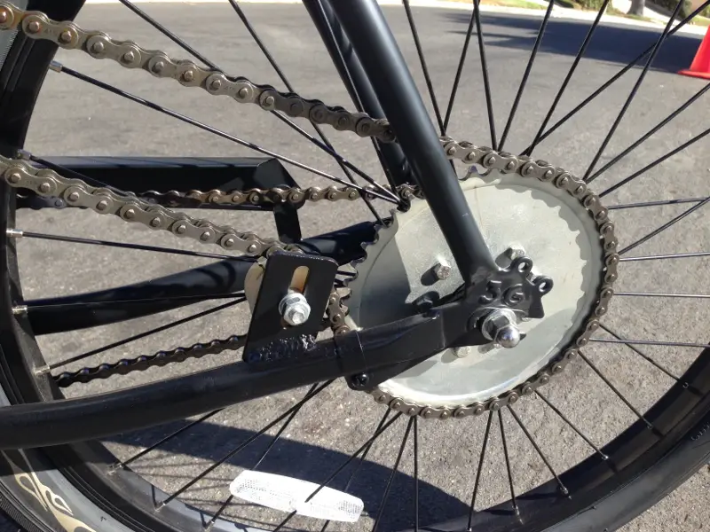

    I also agree with you in principal, Agreen. But, when I installed a motor sprocket that bolted to my disc hub, the chain stays interfered with the path of the chain. I had to install the tensioner to route the chain above the chain stays.
    [​IMG]

    That sort of looks familiar. I think I've seen that idea somewhere
    Great minds do think alike. :)
