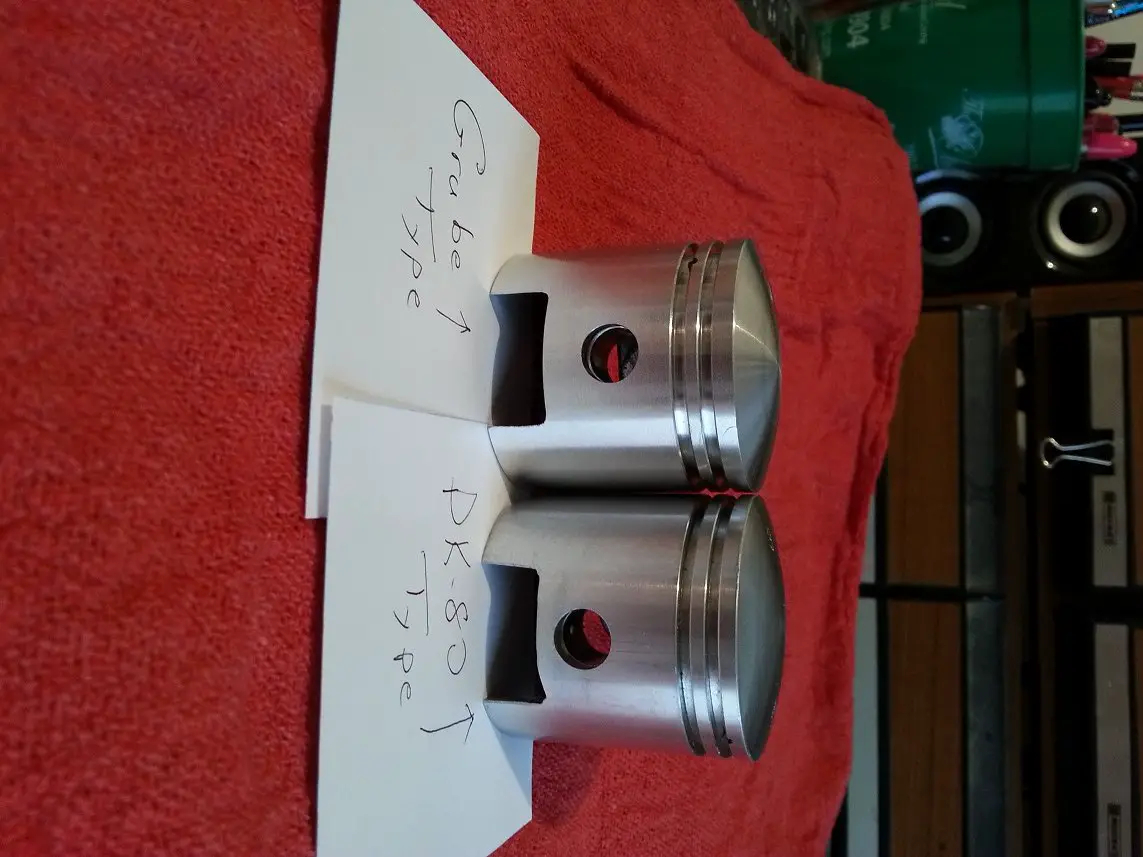

    This is the piston from the original kit.
    [​IMG]
    So when I grab my rear wheel and force it to start rotating without pulling the clutch handel, it makes a "wwwwwhhhhrrrrrrr" sound instead of what im used to hearing "pump-pump-pump" ....
  9. sergman89

    That "chip" is NOT damage. It's the piston orientation mark for assembly.
    Nothing wrong with it unless there damage the pic does not show.

    That triangle mark is to indicate where the ring pins are so points to the intake side.
    All my pistons have them.
    Other pistons have an arrow that points to the exhaust port.
    There was nothing wrong with your piston.

    The pistons are all the same size as in diameter and height.
    Check the wrist pin hole heights.
    The eBay add is for a "SkyHawk" high hole piston.
    The triangle marked piston is a PK 80 low hole piston.

    Sounds like your replacement piston is hitting the head and stopping because the wrist pin hole is higher than the original piston.
    Put your original triangle marked piston back in the motor and hopefully you haven't damaged anything.
    PS: Now I understand why you had to loosen the head bolts to get your motor to turn over!
