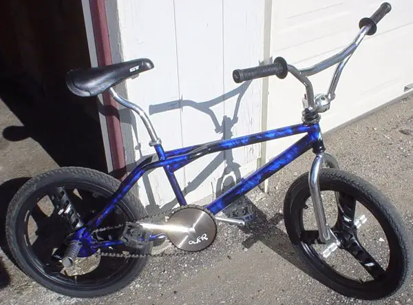

    This is my first post. My name is Chris. I have a few bikes, me and my wife bike on nature trails... But I came across an old Dyno GT, 20" bike.
    I've been looking around, and very few people use 20" bikes it seems. Seems most people, use MBs.
    This is the exact bike I have, minus this guys custom paint he did... I still have the original paint job/stickers.
    [​IMG]
    I want to use this frame bad. I ALWAYS wanted a Dyno when I was a kid, then when I finally came across one, I already had a 200-300$ Hoffman...
    I'm worried if the Dyno will limit me on what engines I can use. But notice how the frame splits into 2 or 3 poles before the seat? Possible mounting spot?! Eh eh?

    Now to the "stealth" you mentioned.......that is gonna be a hard one to accomplish with a 20" bike of that style frame, I dont know of any engine that will fit inside the frame, they are just too small, I also plan to build up a 20" in the future but I plan on going with either an engine mounted over the rear tire or most likely I'll build a pusher trailer, there are a couple other options that can be done but either of these will work the best IMHO.
    A simple pusher set up with the HF 2.5HP might be a very good way to go, if you dont mind the tag along set up of the trailer, or just build you an engine mount behind the seat and put a 28T -30T Sprocket on the rear wheel and you should have a nice 30+ MPH cruising 20" bike, that little 2.5HP 4 stroke engine is gonna be about as quite and stealthy as it gets.
    The only way I can see you mounting an engine in frame would be to cut the frames lower tube and then fabricate another tube that angles more straight forward from the cranks and then sharply angles back up to the steering neck, this would not be that hard to do if you have the tools for it, this would be a very cool set up but the bike would be severely alterd, but in a good way if you really want an in frame engine on it.

    i know that bike well, its an older style GT performer, i had one for a long time, great bike. but i can tell you for sure no HF or chinagirl motor will fit in the frame.

    HF definitely will not fit in there !!! Its pretty tight on my current build
