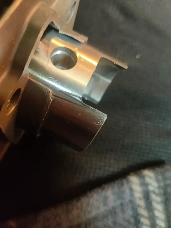

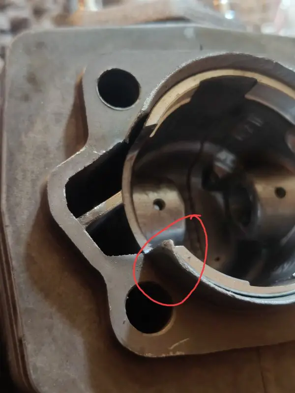

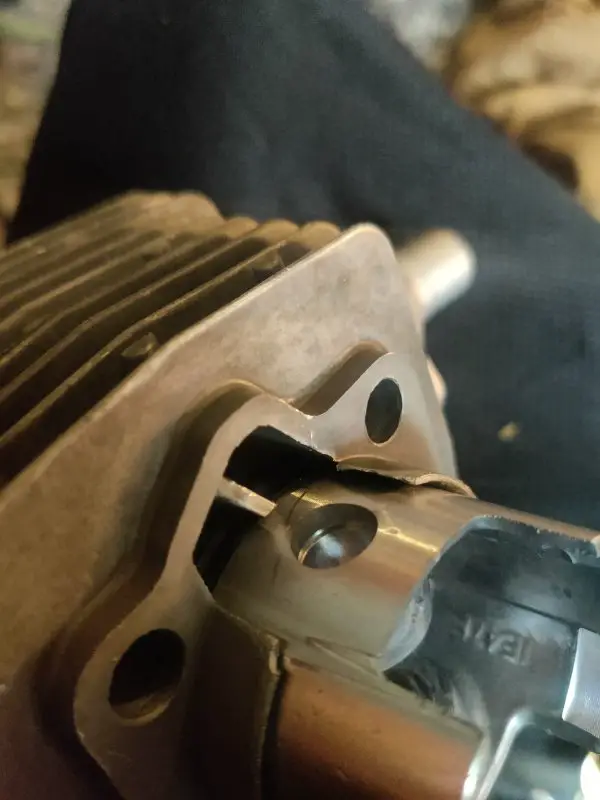

I came from e-bike Land and decided to purchase a zeda 80 belt drive kit for a spare '90s mountain bike steel frame. The kit I received has quite a few jagged edges, one which has scratched the piston, then subsequently broke off completely. It feels pretty cheap but I'm sure a well maintained engine Will last thousands of miles. Will this affect performance in any way? Is this to be expected with all kits?

I would contact the seller for a replacement... It's par for the course with these kits to be cleaned up from the casting flash and debris...

I've contacted the seller to see if they can send a replacement cylinder and piston anyway since the kit is new. I did end up filing down the edges and it's much better. However the scratches on the piston catches my finger nail when I run my finger across it. Is this a problem?

As long as the rings are ok then there really won’t be any issues at all. Do the install and run it, it’s easy to change the cylinder and piston later if it’s weighing on your mind.

A Dremel with a stone and some oil around the ports and all the flash on the original... Or you can sand it with cloth wrapped around your finger but all the sharp junk needs to go... Then you'll have a spare... Flatten out the gasket surfaces... Rince the bottom end out with gas and filter the gas with a coffee filter repeat a few times see what comes out... Then squirt some 2 stroke oil in and around everything and a little on the seals rolling it around... Then put it back together
