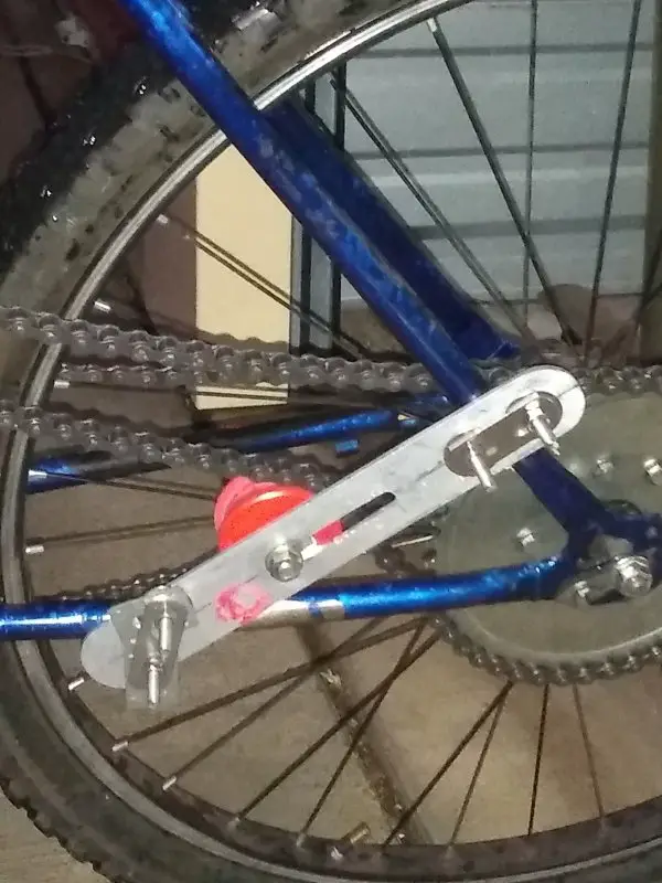

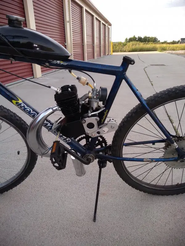

My overall experience with both stock and aftermarket chain tensioners has been a complete headache. I can't even estimate how many hours of my life I've wasted messing with em.
THE STOCK ONE - well...its a spoke killer from **** (could have easily killed me probably too...) After replacing two rear rims i decided it was time to try something else.
THE SPRING/SPROCKET ONE - I started hunting around on Amazon for something better. All the reviews I read said to get one with a spring and a sprocket, so I got this one -https://www.amazon.com/gp/aw/d/B07QJBSBYJ/ref=ya_aw_od_pi?ie=UTF8&psc=1 I was trying to be as frugal as possible, $26 bucks aint terrible. Wish I would have spent more. This one is total junk. I run a #41 chain instead of the stock 415, maybe that has something to do with it, I don't know. I had to remove the master link, and even after that the chain would still rub. I ended up bolting it on the outside of the clutch cover and using some extra spacers to get the sprocket extended to the chain, but even this was a complete fail. I sent that POS right back to China and got my money back.
THE ANSWER - aside from not using one, home made chain tensioners are the best. Your imagination is the limit, and it's built for YOUR bike, not a wide range of bikes that may or may not work well on yours. I spent $25 bucks on the junk one, think I spent $7 making this and it's far superior. $2 for a pair of 1980's roller skates at Goodwill, and $5 for u bolts and hardware. The 1/4" piece of aluminum I had leftover from another project. Since I put it on the bike, I have yet to have to mess with it or do any adjustments of any kind. The one I'm making for my new build will be similar, except I'm using steel instead of aluminum, and welding it directly to the frame (eliminate those ugly u bolts, and my weird mis-mached washers ).
One final thought on the stock tensioner is that they are not all created equal. The one that came with my first kit was terrible, pure trouble from day one. Quite the contrary, the stock one that came with my new kit has been great, it's built much better, and 4 bolts secure it to the frame instead of just two. I'm only replacing it because its permanently ingraved in my brain how quickly it can screw up your ride, and...because I can... That's my two cents worth anyway.

Glad you got the chain tensioner sorted out Jake. Like most things on these one of a kind bikes off the shelf parts often require some or a lot of modification to work on different bikes. The term kit bike is a complete joke and those who try to use them as such are often quite disappointed. Those that modify make a lot of mistakes till they build several of these or fight one till it's right. A decade of building moto bikes has taught me a lot and one lesson is let the newbies make their mistakes and learn the hard way. A lot of experienced post answers and show photos of what works well, but most pay no attention to advise given. I use 415 chain and have never broken or thrown a chain in ten years of riding and I credit that to running perfectly straight chain lines and using well designed spring tensioners that are properly installed. If chains are breaking it's the builders fault not the parts.
I noticed that you are running a rag joint sprocket & these things tend to be very difficult to run concentric (along with other properties) this poor centering causes the chain to run tight in spots and loose in others on each revolution of the wheel & this can break a chain. Using a three bolt sprocket mounted on a good hub adapter is something to consider. Rag joints work ok when properly installed, which few are.
Jake the valve stem should be perfectly vertical, that's a flat waiting to happen. Happy building!

That's my goal lol. Just to go for it and if I make a few mistakes, I'll definitely learn from them. The rag joint tensioner is the one I sent back, I couldn't get it to work right now mater what I did. "Junk" may have been a strong word. I'm sure someone must have had more luck with it or they wouldn't make them. My problem, aside from the chain compleatly shredding it, was bouncing. No matter how tight I set the spring it was just bouncing back and forth. Sounds exactly like you were talking about with tight spots and loose spots being the cause. Good eye seeing the valve stem like that, I didn't. The photo is from last year, and it most definitely DID cause a flat. As always, thank you Indian for your words of wisdom, it is most appreciated.

The only thing I had trouble with it was spacing the gear sprocket and I really didn't like using them since you do get
noise off of them which might be caused by the #41 chain I'm running since a 415 chain will not hold this engine.
The price is high just because of that sprocket on it and since it is a CNC piece of aluminum work that adds to the
cost. I removed the sprocket and used a new high quality nylon bearing roller and that was the way to go with it.
If a fella had the time and machine tools it would be easy to duplicate it but then you have to purchase the material
and hardware. I also did not like the small screw and nut used to hold the band on the front I thought it was too
light and went several sizes bigger. A allen capscrew, washers and a nut would be a good option.
I have tried several and spent way too much on the spring type and minibike ones that really don't fit a bike.
The $20 arched and slotted steel on is a good one but I never cared for the looks of it and it is more placed
towards the middle of the chain. That unit will not get into the spokes and is a quick solution to a chain
tensioner. The ManicMechanic one is positioned closer to the rear axle and chain adjustment is quick plus
it's not a eye-sore in looks and won't get into the bike's spokes.
